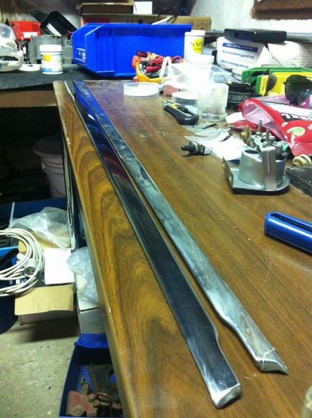

Question for sheet metal pros :
I started to straighten ou a big impact in my chrome trim.
I knocked softly with some wooden block, then sanded with 800 paper and finish to a rough polishing just to see how it looks like.
But the defect is still there.
Do you have some tricks to have beautiful straight trim?
Quentin
stripedelete
Picked up a few things from my uncle.  Work the dent/ding in reverse.  The outside edges were the first to move when the dent was created.  Start on the outside and work your way in.  You will end up with too much metal when your done.  You will have have to get rid of it.  You will probably have to start with a file and work your way through sand paper to cutting polishes on the wheel.   Some times when you have too much metal you have to shrink it using heat and cold.  But that's way out of my league and I'm not sure it applies to stainless.
You will need some tools.  I have no idea what they are called.  But it's a collection of drifts, punches,  flat and angled metal blocks etc.
My uncle restored early 20Th century vehicles for a living.  Metal work took too much of his profit, so he attended what he referred to as a seminar, bought some tools, and started practicing.  I'm sure today's  equivalent to that "seminar" could be found on DVD or youtube.
He is considered quite accomplished and at the age of 90 still saves one-of-a-kind trim pieces which have been turned away by respected shops.  With that said, he could not fix my wheel lip moldings.  There is much more going on with them than it appears.  So don't knock yourself out there.   :Twocents:

There's some information on repairing trim in Larry Lyles' "Project Charger" book. It's definitely worth a read. I was given a copy at the beginning of my project and I still reference it constantly.
http://www.amazon.com/Project-Charger-Step-Step-Restoration/dp/193199322X
six-tee-nine
the plus : you dont need alot of expensive tools
the minus : you need a sh*tload of patience wich you cant buy. stripe delete is spot on with his explanation.

My problem with beer drinking buddy's is that they lack skills to polish stainless trim, so i need to do it myself I guess...

PtitRaisin
Thanks all.
I made some wooden tool and give my patience. It's going the right way. Pics to come.

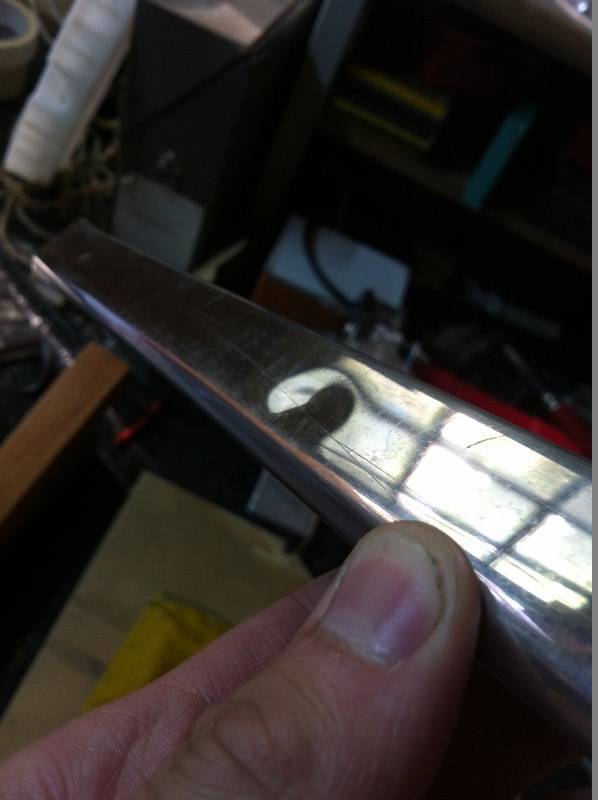

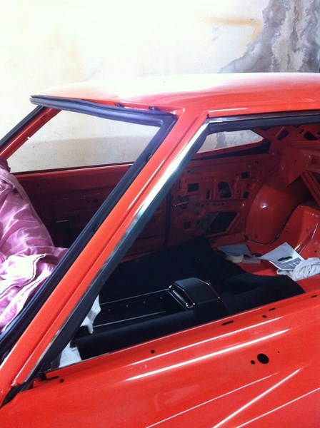

Things are looking good on chrome trim side. Patience finally pays off!
It's not perfect like I would want to, but it's correct and presentable :
I have to give a last polishing to finish. Because some micro scratches are remaining.
One question concerning the seal. Do I have to stick it in the rail or not?

Help !
Someone car tell me how to install the quarter glass outer trim?
Do I have to bolt or put some plastic inserts ?
Thanks in advance
Quentin
Charger-Bodie
There is a funny looking j clip that goes there made of spring steel.
68 383 auto with a/c and power windows. Now 572 hemi 5 speed jj1 gold black interior .
chaos52
Someone correct me if I'm wrong, but I think you need some of these clip-on nuts. I don't know the official term.
