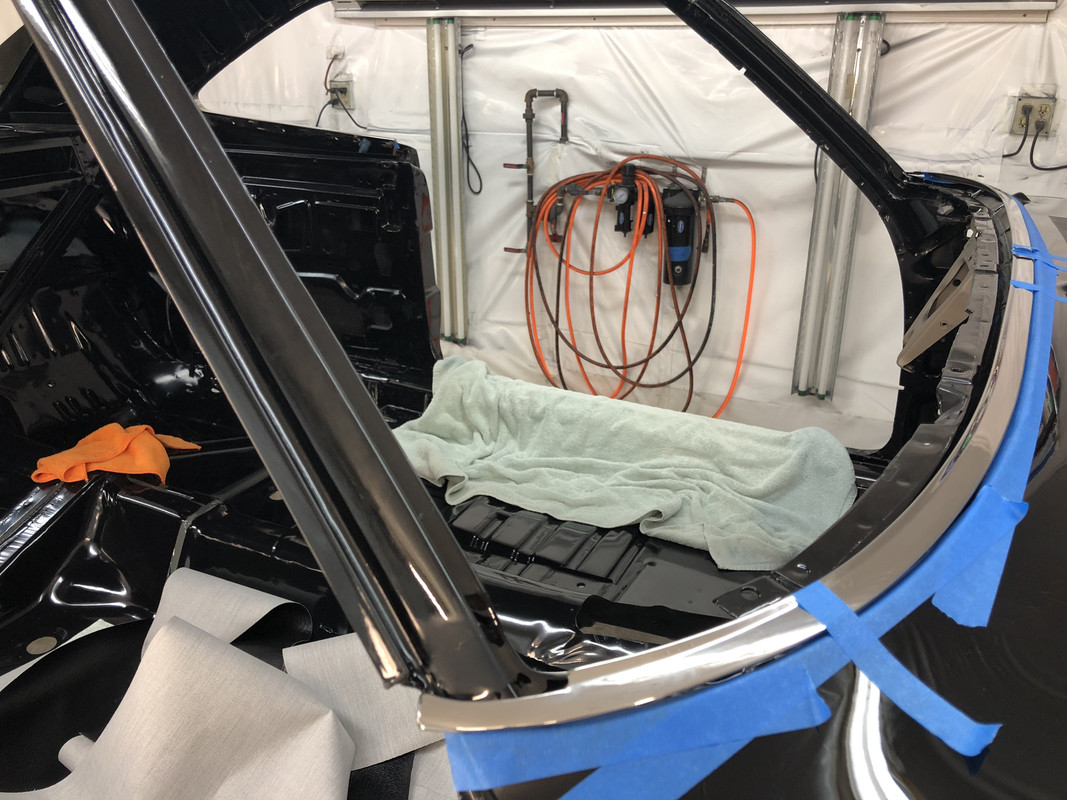

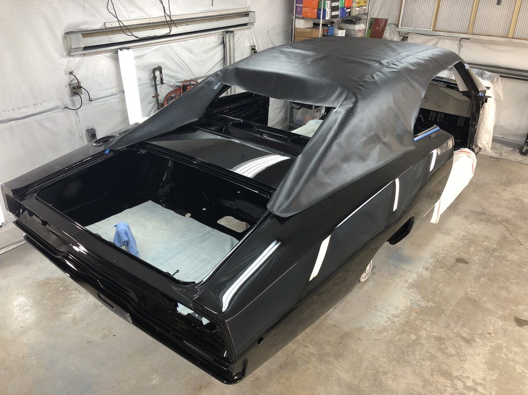

I'm installing the vinyl top over the 4th of July holiday. So I started by putting all of the vinyl top trim so I know where to locate the final cut. For the last 3 years this top has been laying over my Trans Am or viper. It's nice to have it laying on the charger now ;-)
Thanks
Pat

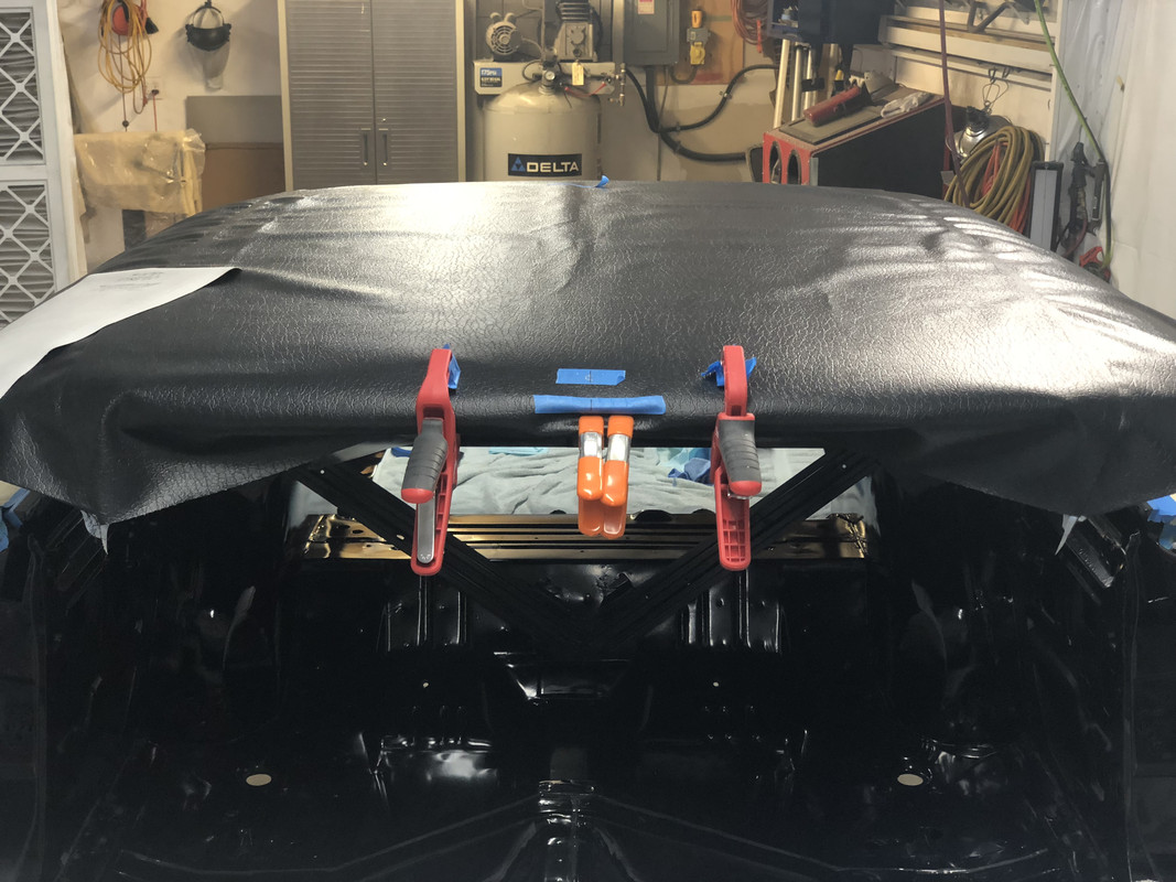

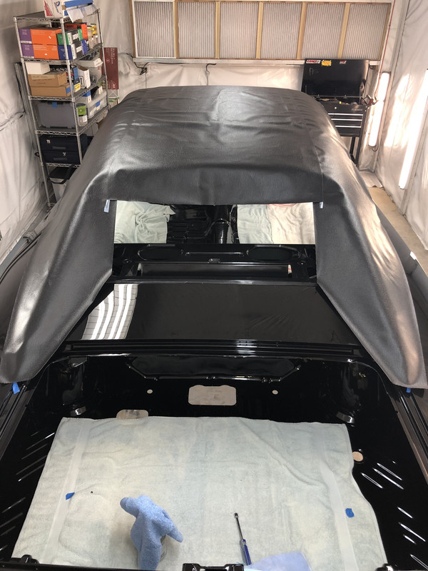

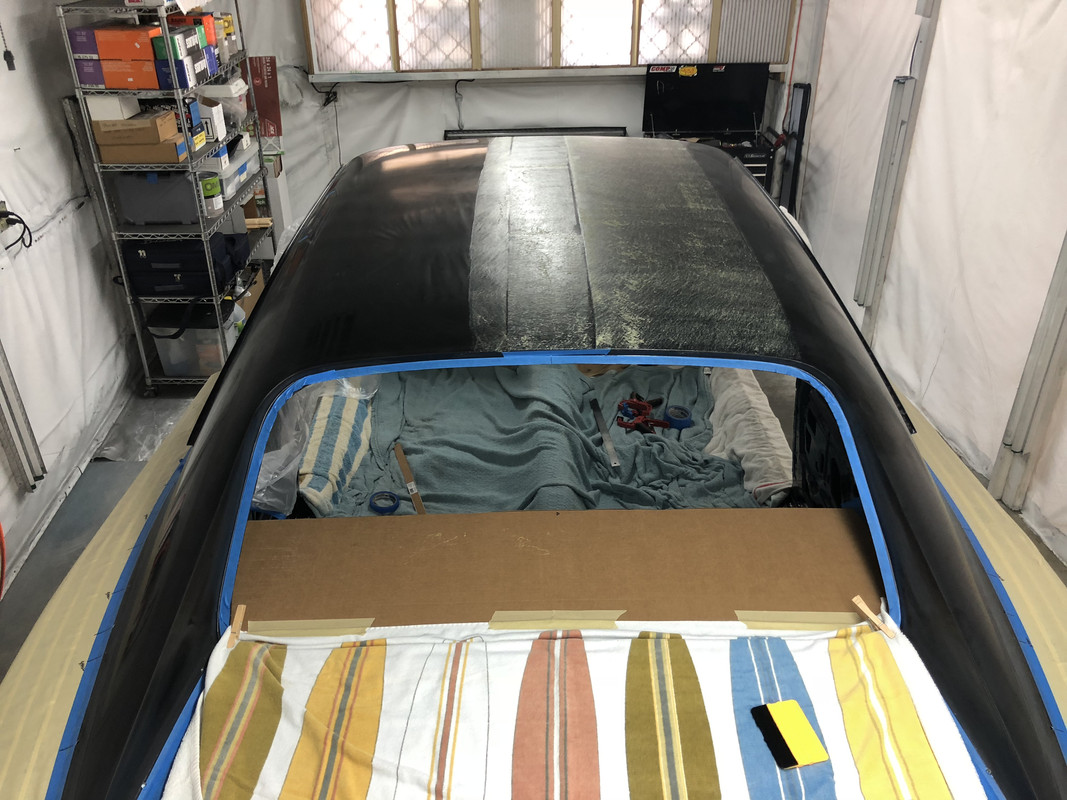

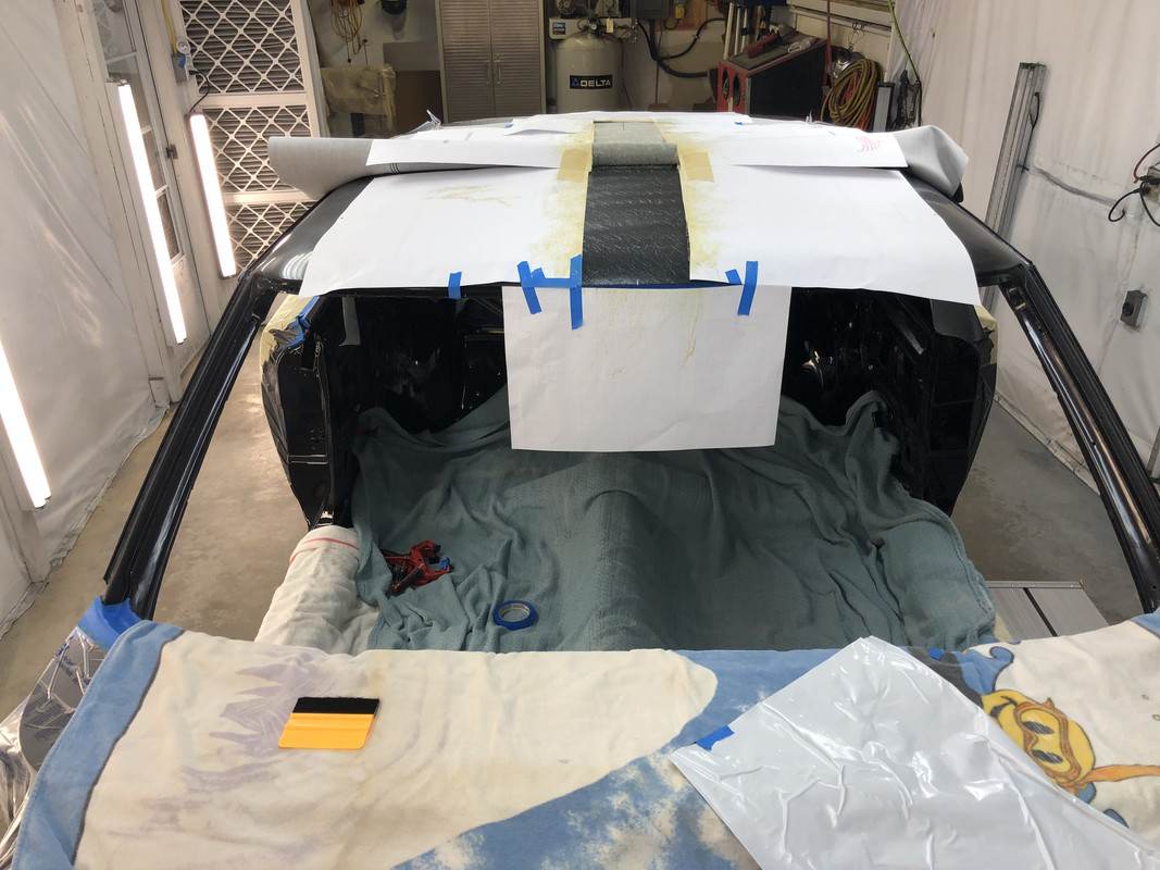

With the vinyl seams even and clamped at the front I glue the center 6" back to front. Then folding over the drivers side I glue over to the seam and then the same on the right side. After spraying the glue on both the roof and vinyl I put some plastic down to let me flip the vinyl over without sticking. Then holding and pulling the vinyl up I remove the plastic and stick the the vinyl down. Now with it glue seam to seam next will be down the pillars.
Thanks
Pat

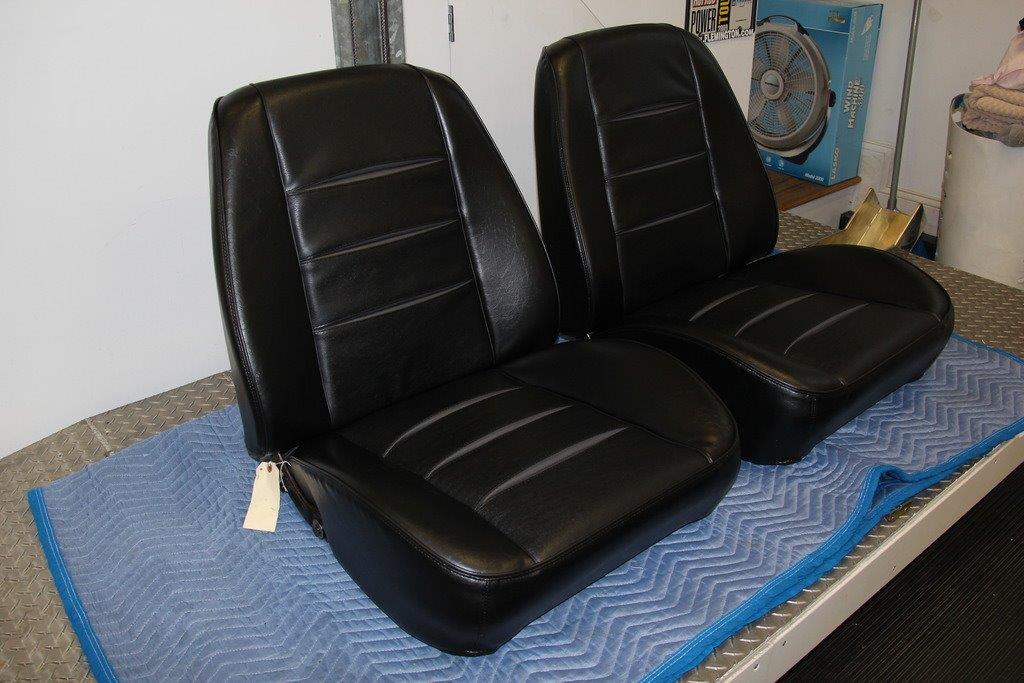

What are you doing for front seats?

I hope those are the retro "Car Show" seats and you set the base of the seats to also accept a nice set of quick change out Recaro seats, or equal for daily driving.

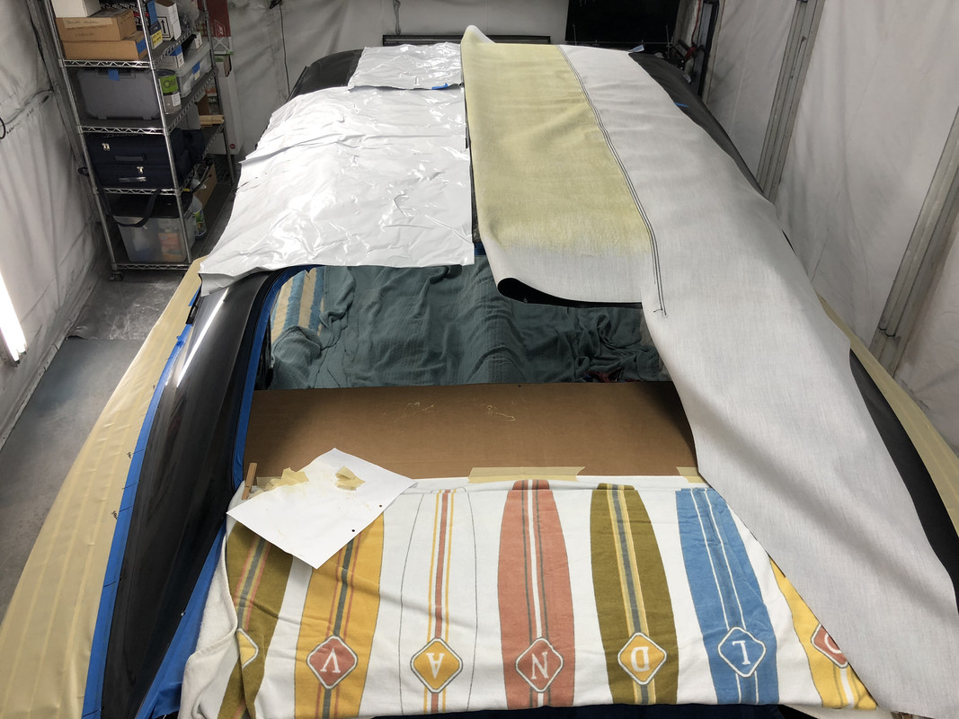

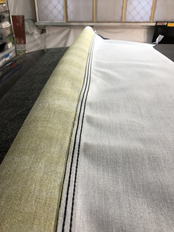

Had a setback on the vinyl top. There was a wrinkle on the driver side seam that I initially thought was from me over or under stretching the top when I glue that side down? But after investigating it a little closer it turned out the top was stitched crooked. I bought this top along with all of the interior components over 4 years ago from Legendary Auto Interior. I sent them pictures and a description of the problem and they quickly came back and said they would send me a new vinyl top. That's first class customer service in my book! I was taught a long time ago by the guy I work for, don't judge one by their mistakes but rather by their solutions!
Fortunately the top removed relatively easily and I was able to remove the contact cement by rubbing it with mineral spirits. I get to start over sometime next week when I receive the new top.

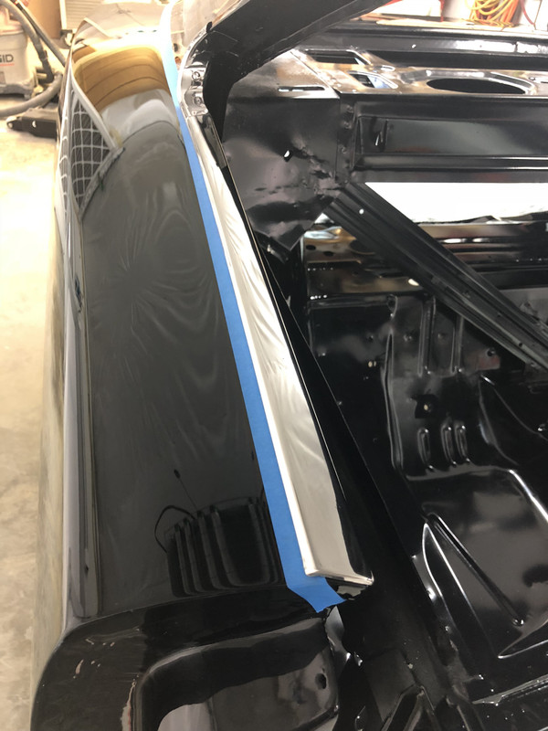

I may have missed it but why did you need to sand the paint just above the vinyl top trim?

I did not paint the roof with as much paint as the quarters received so there was a transition line that I wanted to blend that would have shown through the vinyl top.
