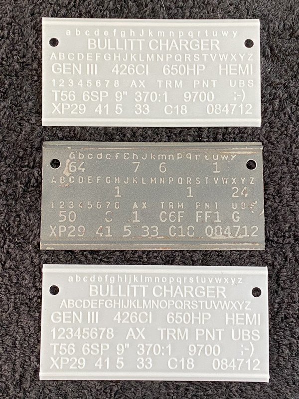

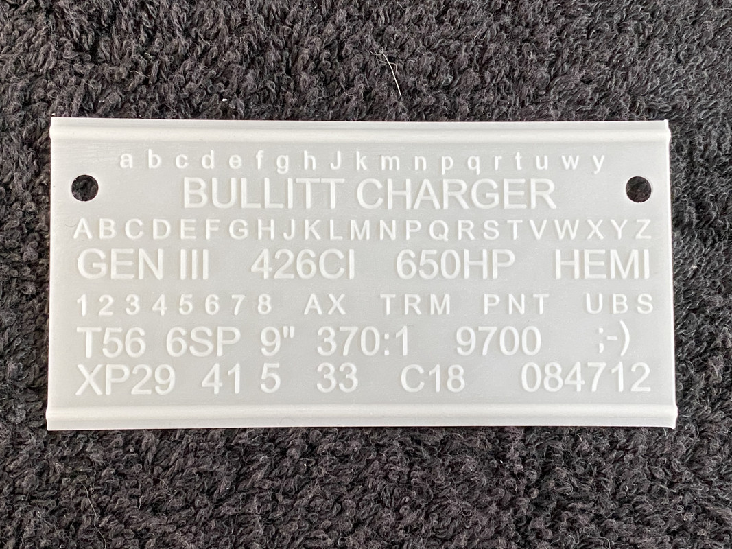

I received the 2nd version of my custom 3D printed fender tag from Dan at http://www.nextgendesignsnc.com/  . We made a few changes in the font size, letters in the alphabet and spacing. Hope to paint it black and install it on the inner fender soon. Dan is great to work with, and I'm very happy with the tag!

orange383
The fender tag is a great idea.

Quote from: orange383 on April 18, 2020, 02:21:37 PM
Thanks! I think it's cool too!

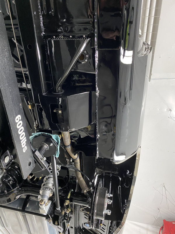

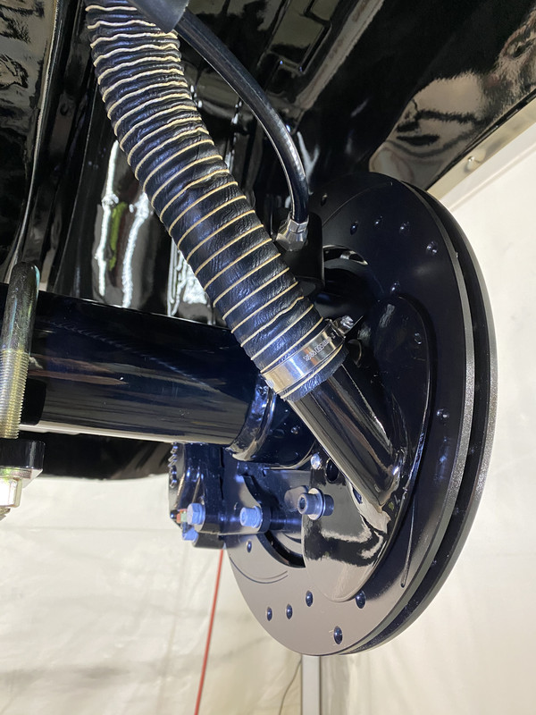

Rear brake coolers painted and installed. Still working on a few ideas for the air intake screen.

70 sublime
Um question
After you get this masterpiece done are you going to drive it hard enough that the brakes will get hot and could benefit from cooling ?
Car looks great  :2thumbs:
keepat
Quote from: 70 sublime on April 26, 2020, 09:30:23 AM
Um question
I plan to get on a few tracks when it's done. But you never know when you may find a Highland green Mustang in your rearview mirror;-)

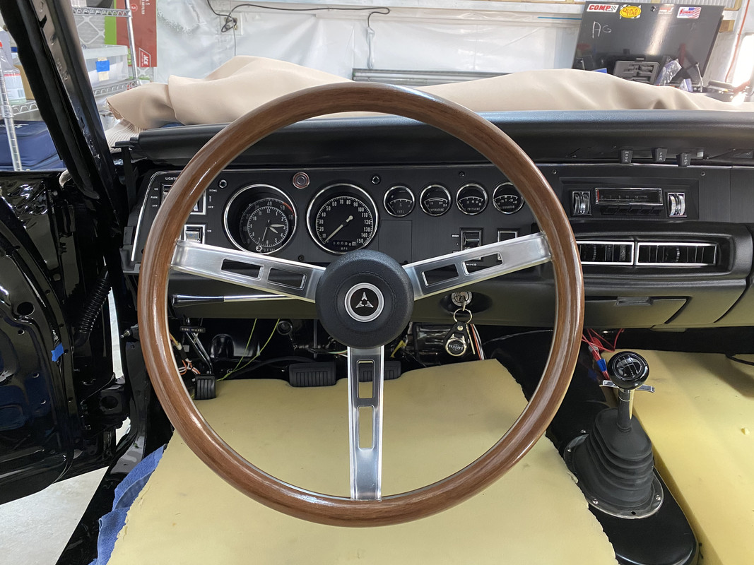

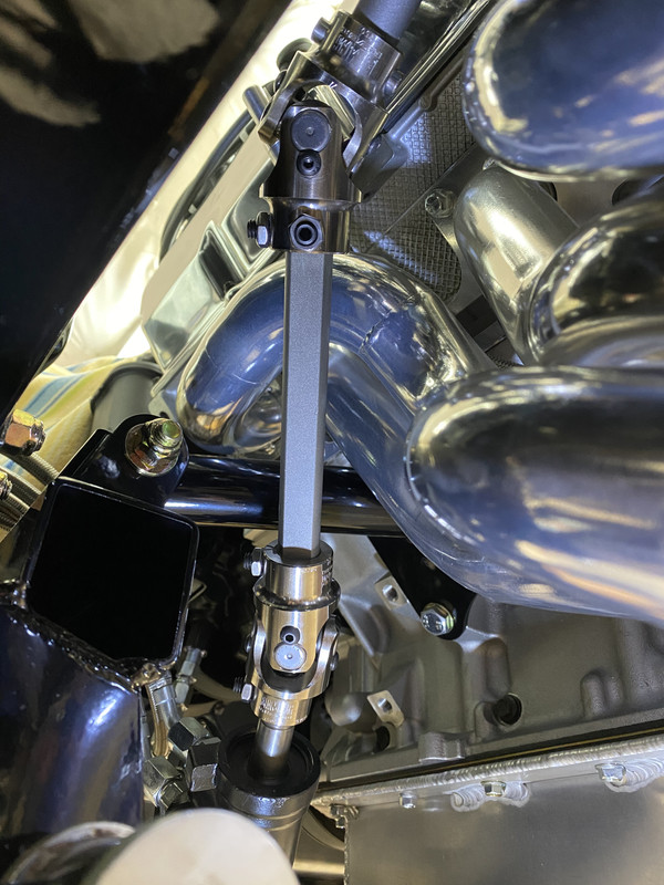

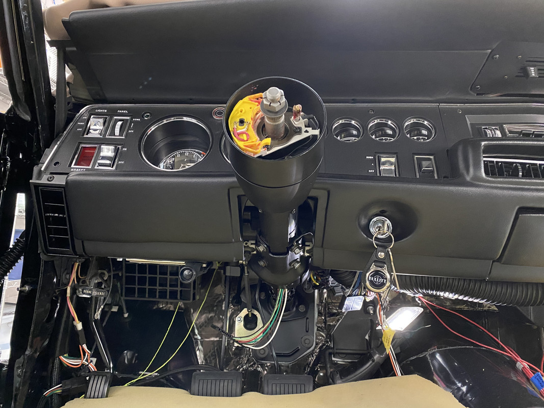

I installed the steering column and the custom thicker grip steering wheel I made a few years ago. The thicker steering wheel is so much more comfortable then the thin original.

This is one sweet car. I think your sound deadening material is a little thick.
mopar4don
I absolutely love that wheel  :drool5:
XH29N0G
You never ever cease to amaze me.  I really love seeing the build and the ideas that have gone into it.   :2thumbs:

keepat
Quote from: orange383 on May 19, 2020, 10:14:31 AM
Looking real good Pat.
Quote from: Fitz73Chrgr on May 19, 2020, 10:47:33 AM
Awesome
Thank you gentlemen!
Quote from: krops cars on May 19, 2020, 01:55:58 PM
Yeah, but it's real comfy ;-)
Thank you!
Quote from: mopar4don on May 19, 2020, 03:13:58 PM
Thank you Don. I'm very happy with it and look forward to seeing how it works on the road.
Quote from: XH29N0G on May 19, 2020, 04:06:23 PM
Thank you for the kind words, and following along on this very long build.

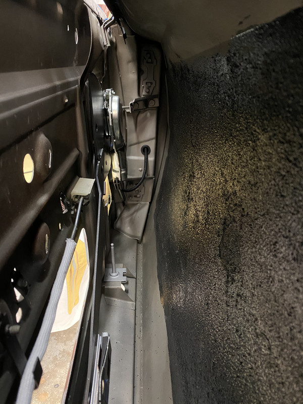

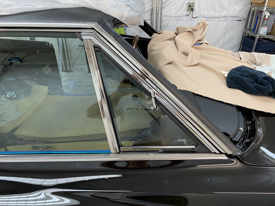

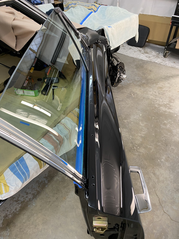

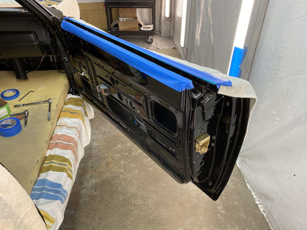

Installed the right side vent and door glass this week end. Very happy with the aftermarket power window regulator.
Thanks
Pat

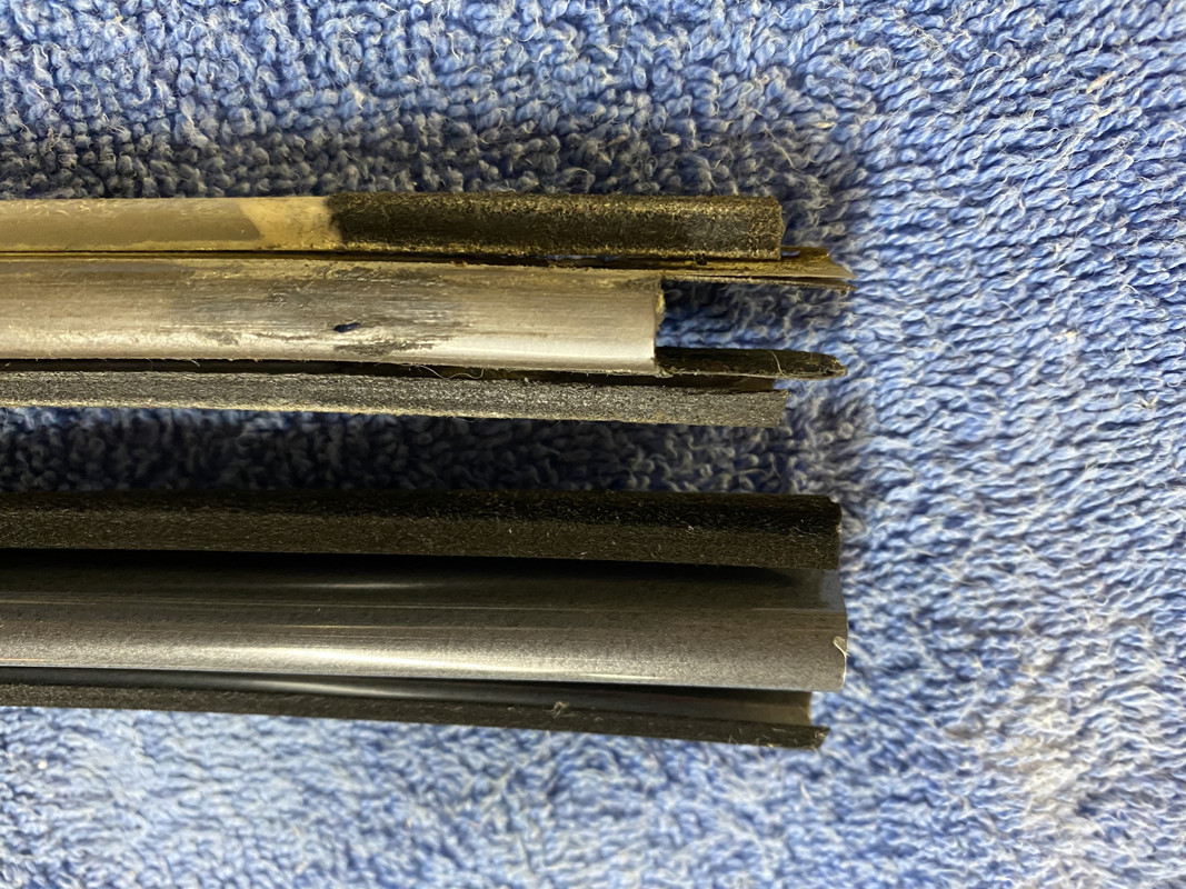

So what is the 2nd and 3rd pic?
Also are those original belt molding clips or did you find some re-popped ones?
keepat
Quote from: mopar4don on May 26, 2020, 07:32:55 AM
Awesome Pat!
Hi Don,
The 2nd & 3rd pic is the felt that attaches to the front of the door glass. One original and one repro, to show how I found the top cut to fit.
As for trim clips, all are originals except for the aft bolt on clip. I repainted as I found and I got the bolt on clip from RT Specialty. The new bolt on clip need to be cut down as it is to wide.
Thank you!
Pat

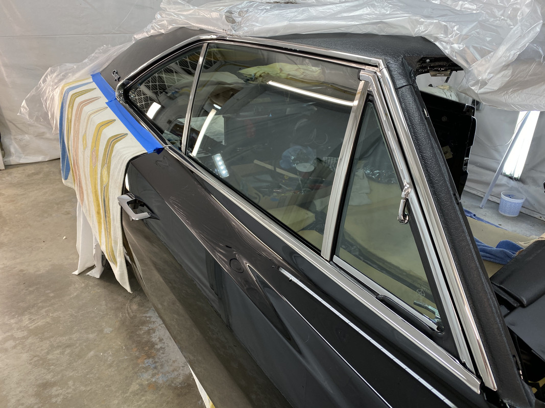

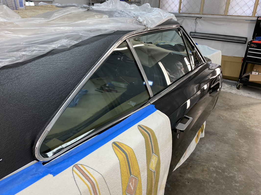

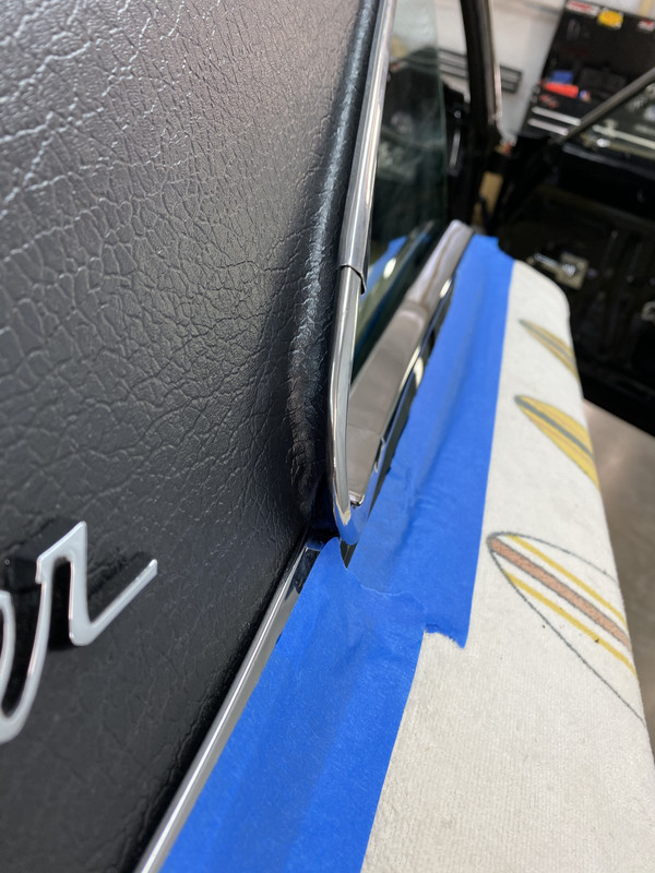

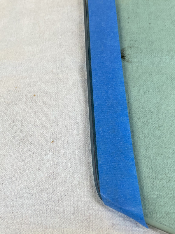

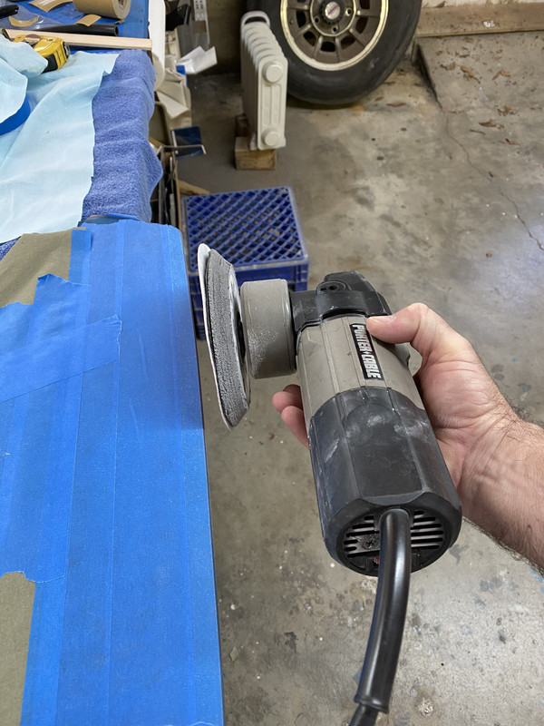

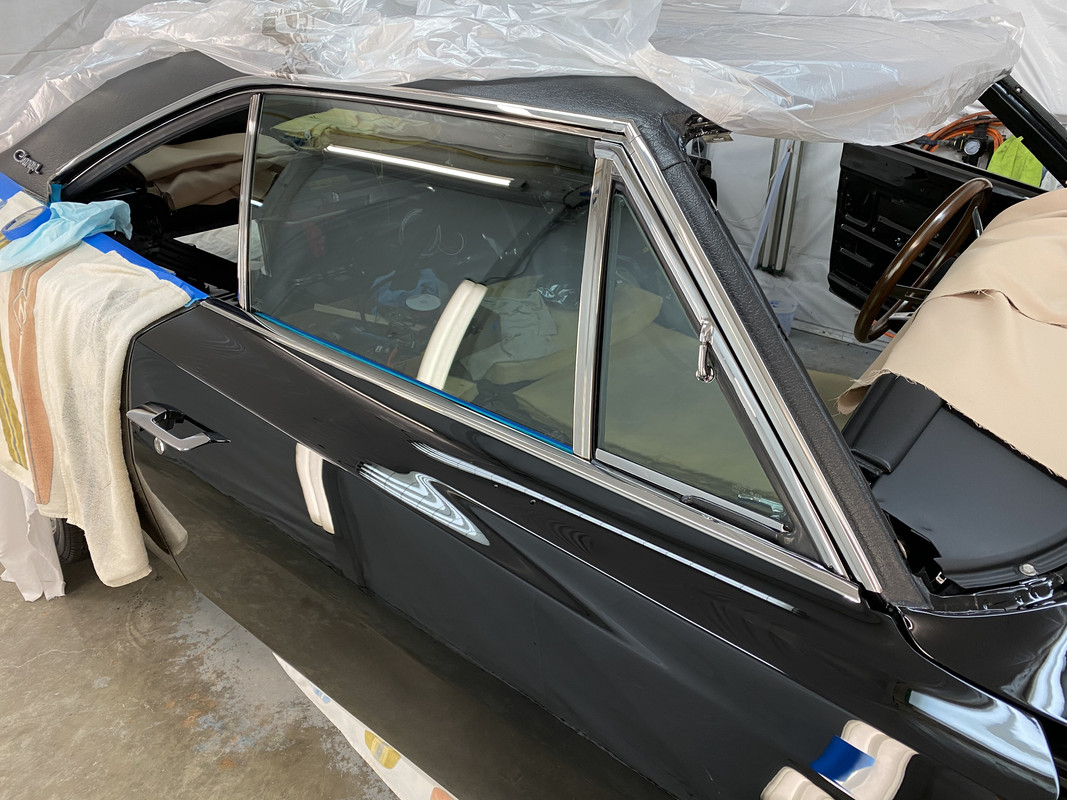

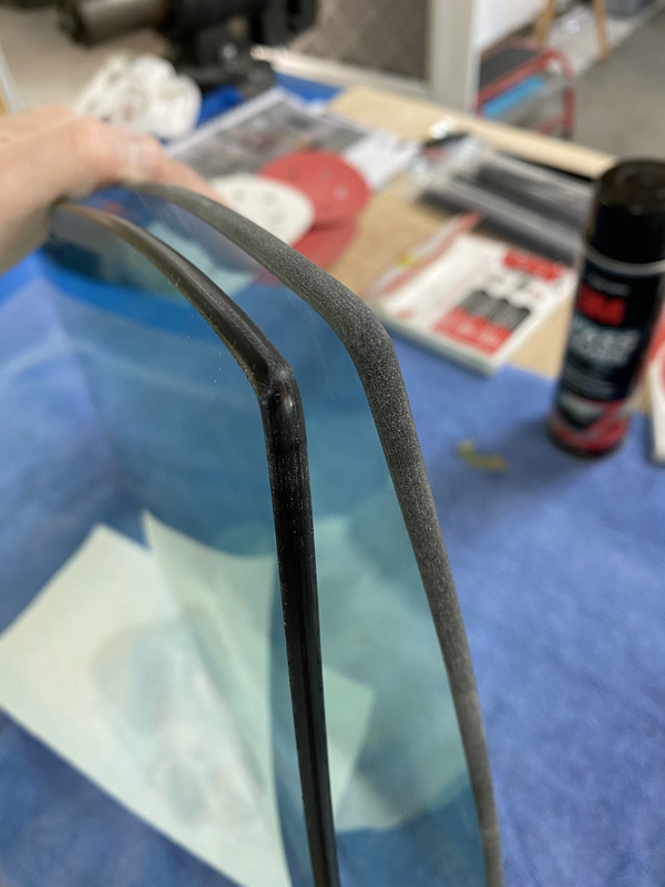

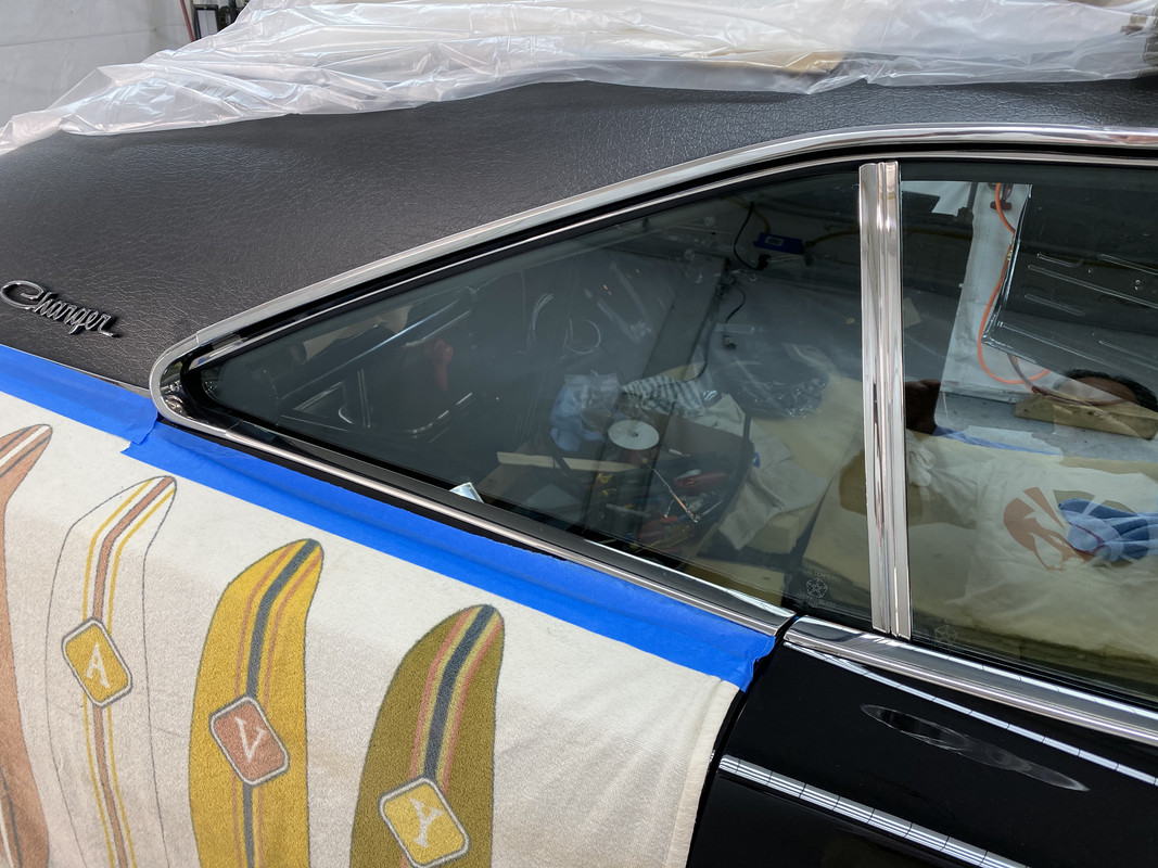

I Installed the passenger side rear window and trim. The AMD quarter glass was a heavy 1/16" taller on the rear 12 inches compared to the original. So I had to sand it down with a DA sander to get the best fit. All of the AMD glass has a rough finish on edge so I use the DA sander starting with 60 grit and working my way to 180 to polished edges that shows.
Thanks
Pat
