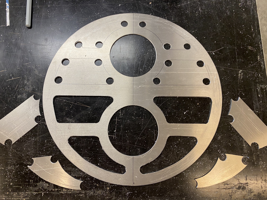

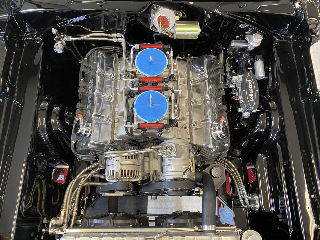

To get the hood clearance for the 1968 hemi air cleaner I had to make a custom base and air filter. Started with a cardboard template before making it out of 1/8" aluminum plate.
I think the 1" velocity stacks worked well.

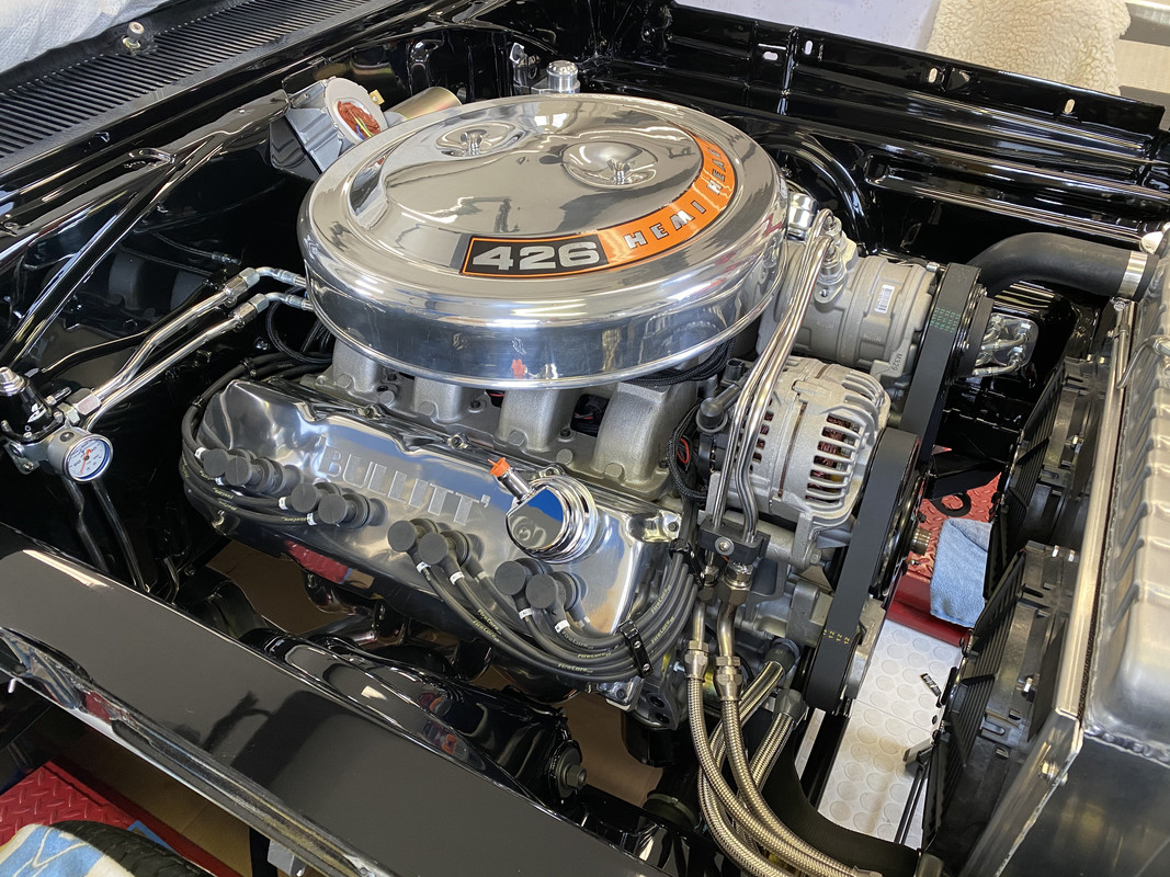

Is that an aluminum dome air cleaner?
68 Charger R/t white with black v/t and red tailstripe. 440 4 speed ,black interior
68 383 auto with a/c and power windows. Now 440 4 speed jj1 gold black interior .
keepat
Quote from: Charger-Bodie on January 08, 2021, 03:36:32 PM
Yes sir, I bought it from a supplier in Canada. I'm trying to keep the all aluminum theme with the motor, oil pan to air cleaner.
