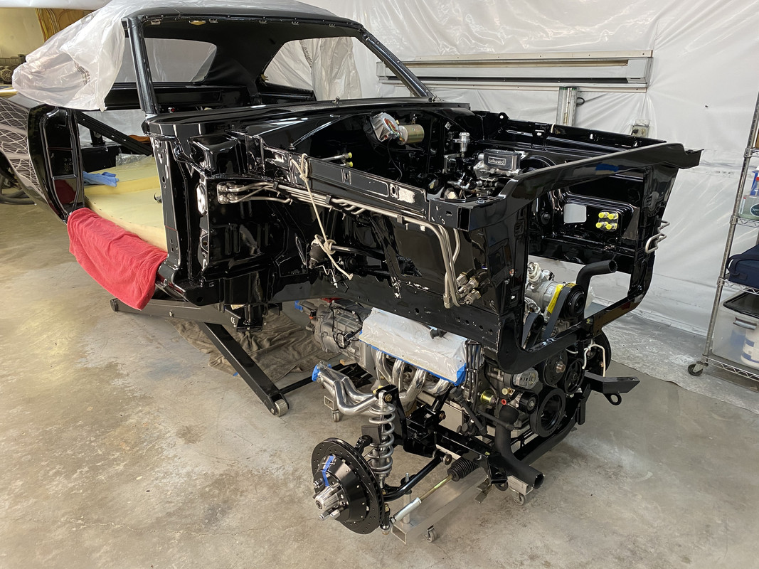

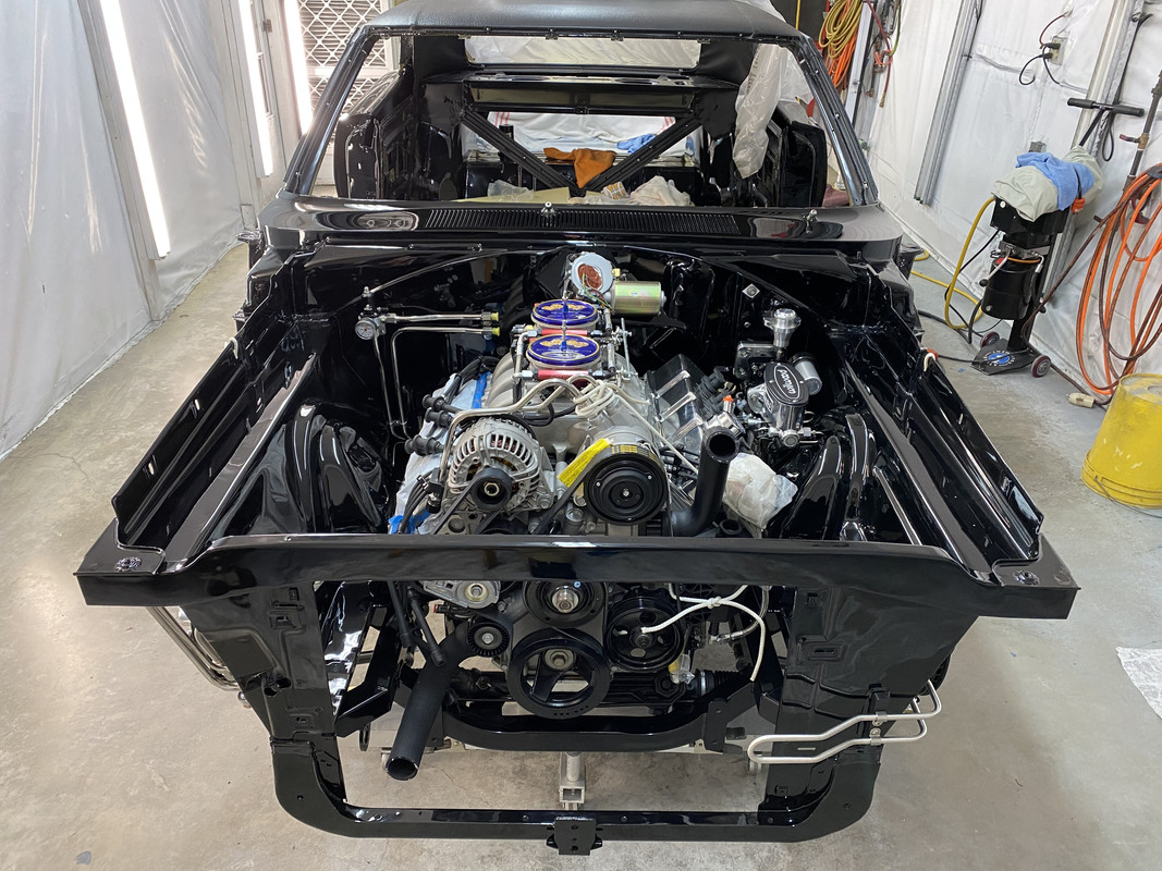

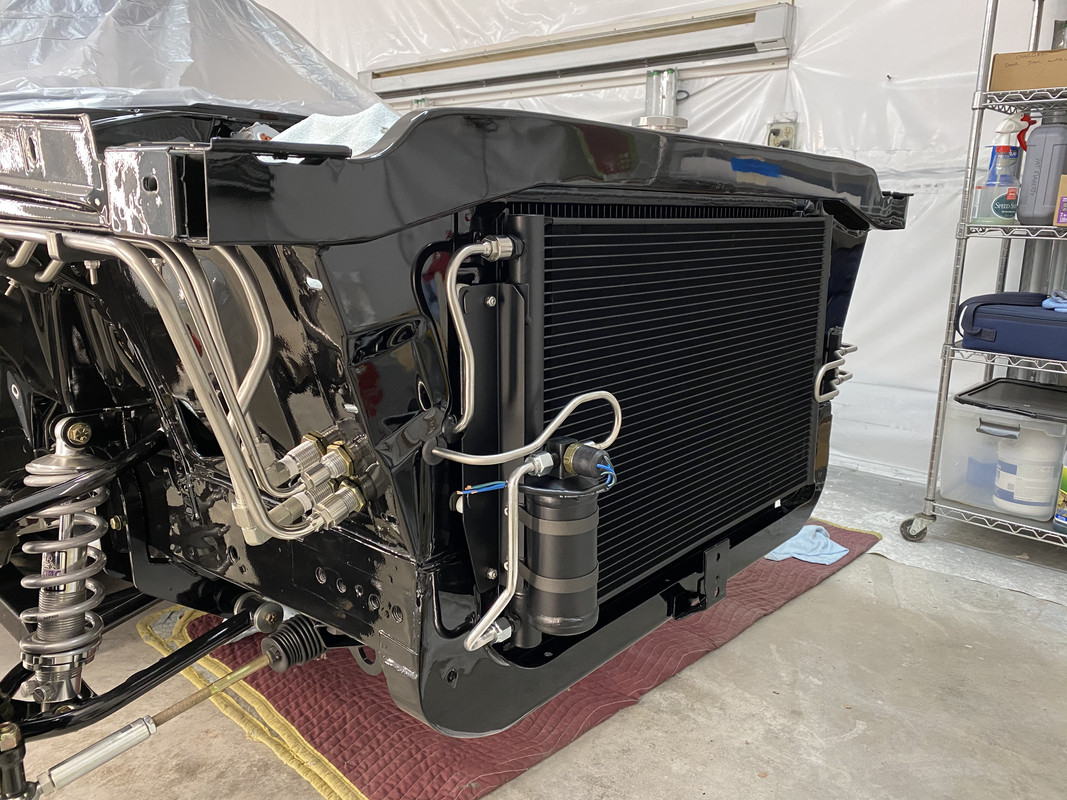

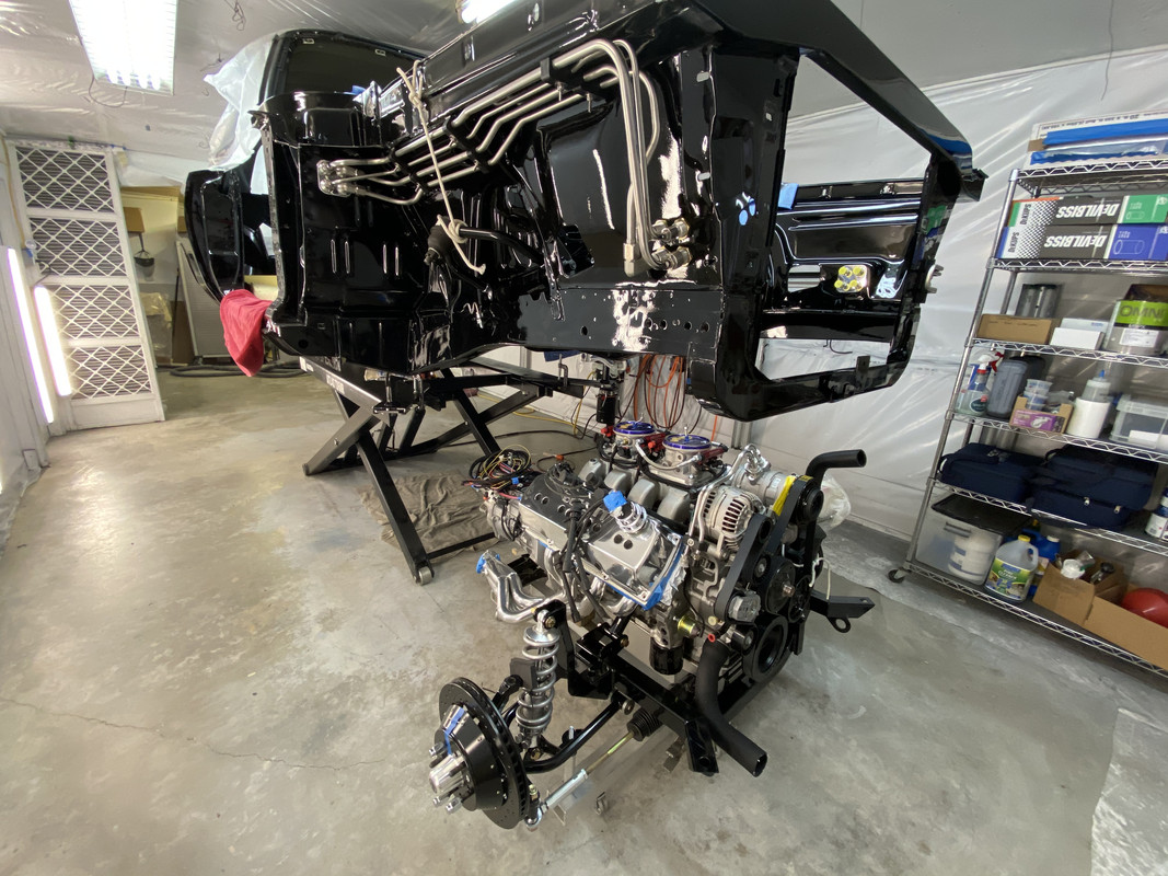

Moving along with a few projects! All the fuel, AC, and Hydroboost lines hooked up! Trans cross member and shifter is installed.
Thanks
Pat

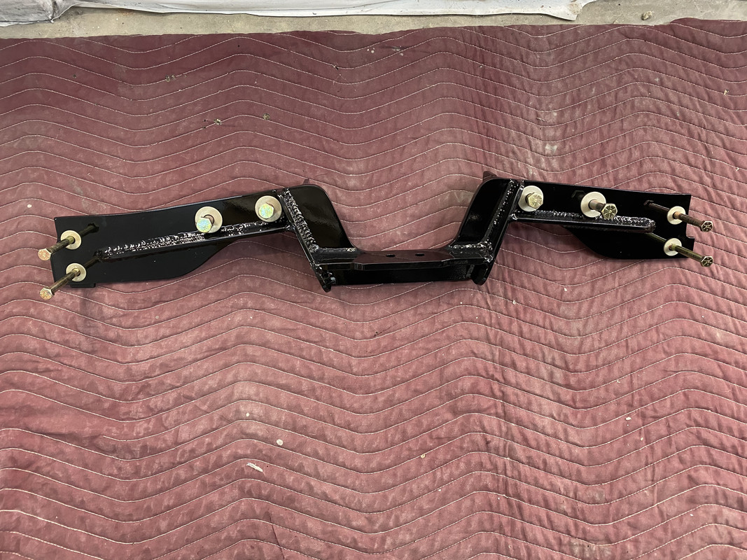

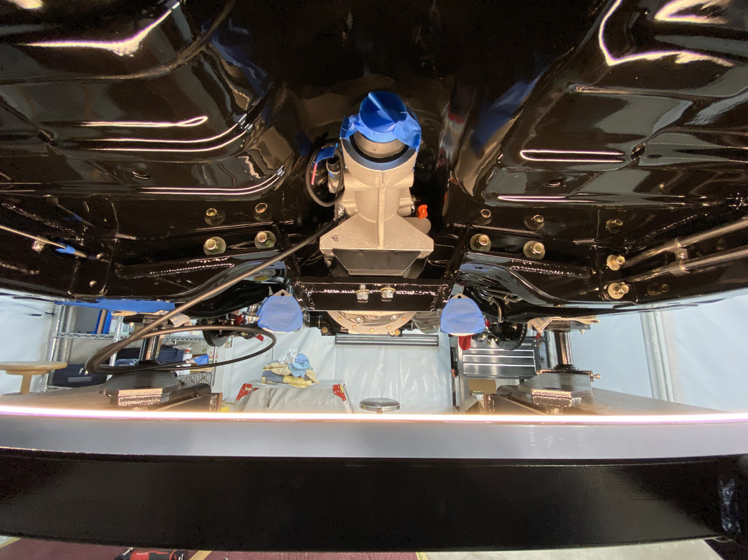

you may have said  and i missed it ?  but did you tranny crossmember come with a kit or did you make it  ?

Quote from: moparstuart on December 24, 2019, 11:19:55 AM
When I bought the transmission set up, at the time there was not a crossmember available for the six speed, so I made one. I believe now there is a crossmember available form SST.

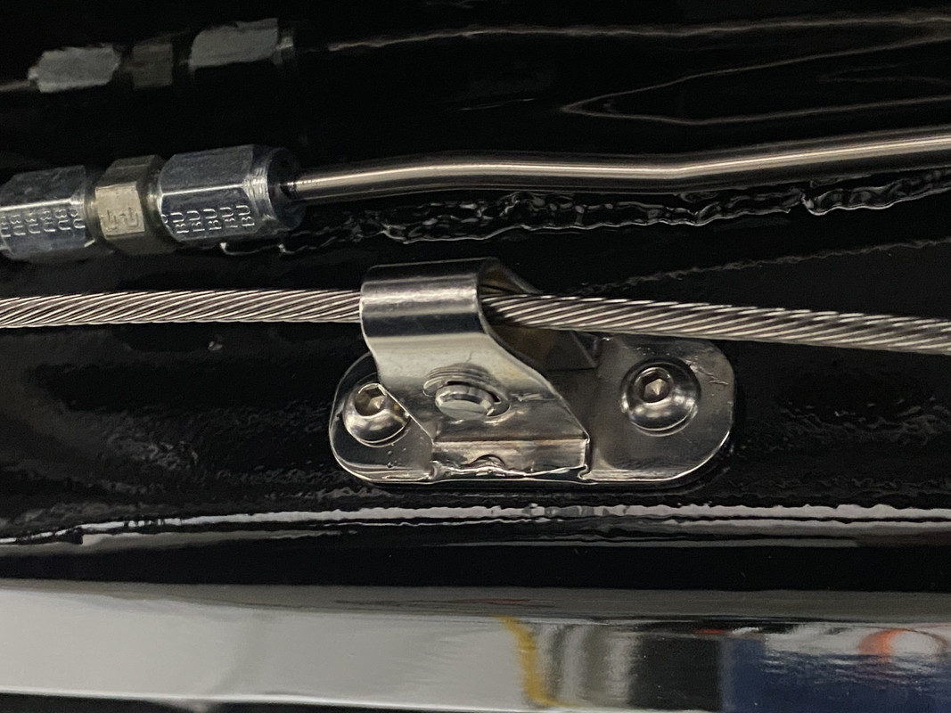

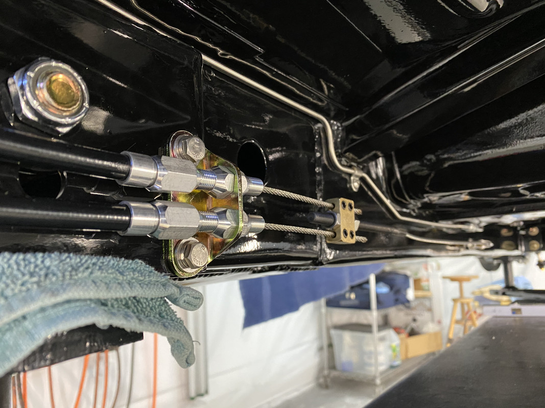

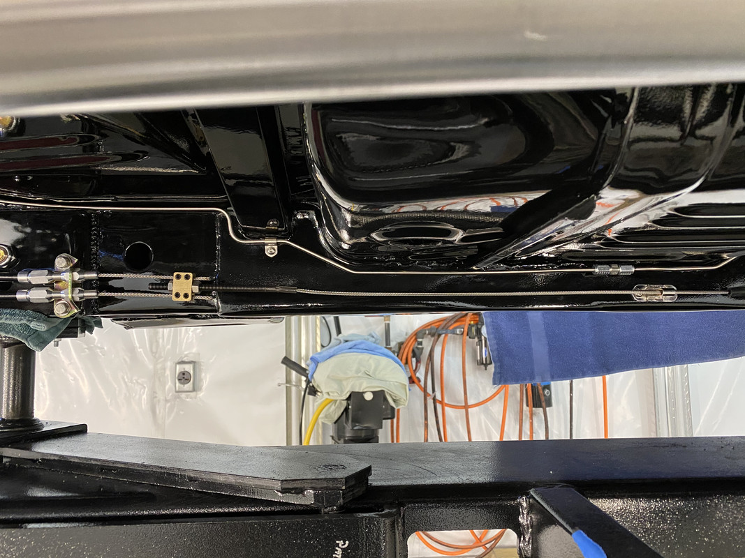

Emergency brake cables installed using a small stainless steel roller that I got from West Marine. It guide the E brake cable after it passes through the sub frame connector.
Thanks
Pat

i got mine from hurst very early in the 6 speed conversions , it does the job but i have to cut on it and modify it .   yours looks great

The Shifter Nob Is labeled with a 4 Speed Pattern.
Was that done on purpose to hide the resto-mod aspect?

I'm planning on engraving the 6 speed into the knob but I just haven't decided how I'm going to do it?? May just mill off the 4 speed and make an insert? I'm also sending the shifter and T handle to be rechromed.
