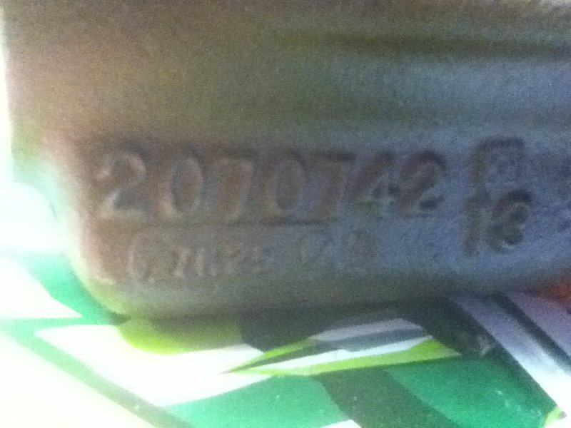

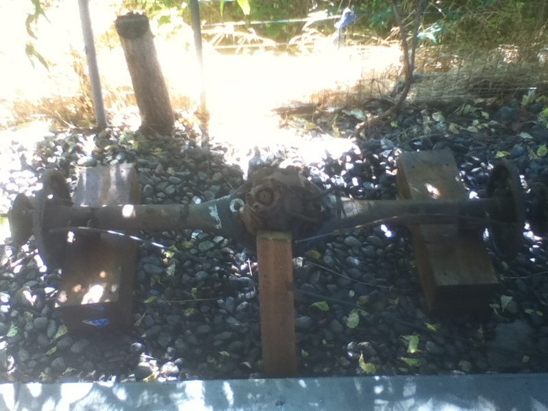

Got it completely stripped down, and third member clean (still need to sandblast and paint the exterior). Looks like I'll be ordering new internals for the SG. A couple of the gears have rust on their teeth from sitting without oil so long.
I cut the perches off and ground the parting lines smooth on the tubes. I also ground down the joint welds on the top and bottom then got them welded back up. The welds were gobbled up and there was a split all the way across on the inside and outside welds. Now they are clean and look pretty too.
I am going to get the tools to narrow the rear end and figure out how narrow its going to get. Frame rails will be 28" on the outside, and 4 link brackets are inline with the rails.

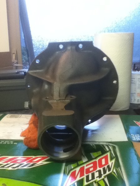

Third member has been hot tanked, sand blasted, and coated with fogging oil. When I'm done using it while to narrow the tubes, it will get washed a couple more times then rebuilt and painted.
