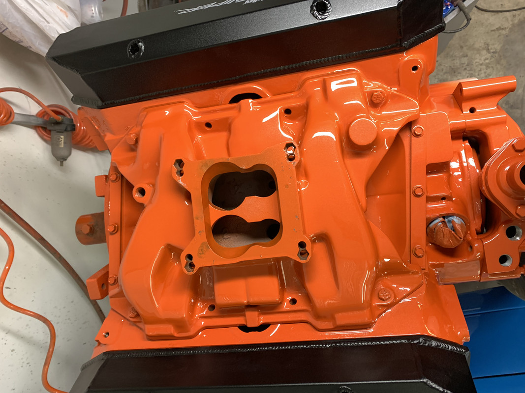

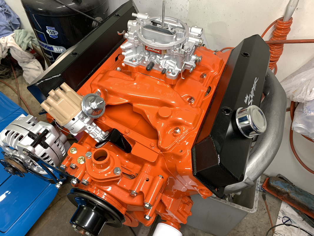

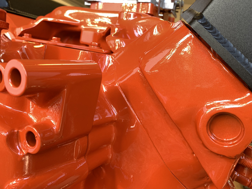

This 69 440 was in my Yellow Daytona. This will be on display in my Mopar Man Cave. I detailed out the motor. I did this to my HEMI and I love it because it stays cleaner and cleans easier. Can anyone guess what intake this is?

think the intake was originally a 3870733 or may be a  3751728 ,

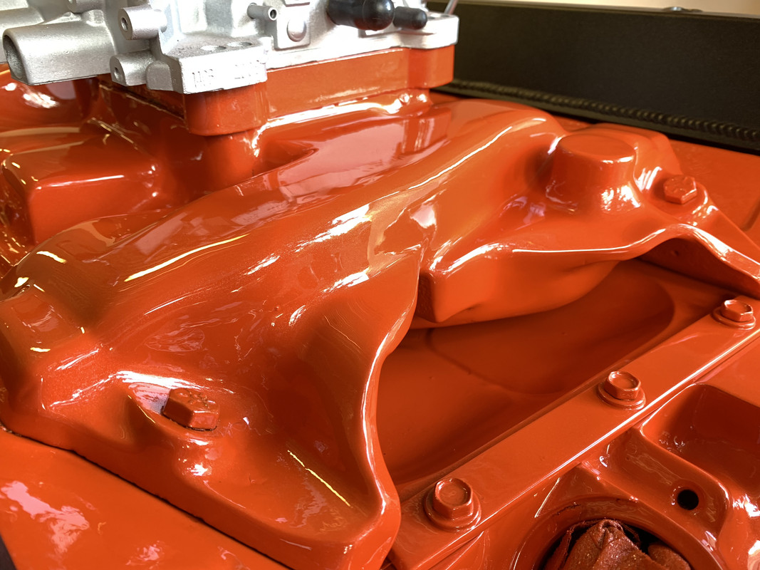

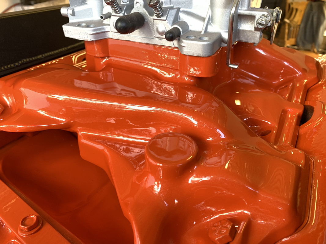

Yeah, did you just wet sand that and buff it out?  I'm curious.   Ceramic paint?

Nice!!! Where can I get a set of the valve covers?

Single stage acrylic enamel DuPont sub-brand ($30.00)- Hardener with lacquer thinner for fast dry time. Cheap and simple. To be honest, I wish my car plaint jobs looked this good. Single stage is underrated. Did not color sand it at all - right from the $15.00 Harbor Freight gun. There is a trick - not letting as much paint through with a lot of air - very fine aspiration - fine particulates.
Valve covers 133.00 Holly Snyper - Amazon - they will be painted over Satin black with a mopar emblem
The intake is highly modified - the round part will have a MOPAR "M" in it. More pics to follow, if anyone cares LOL

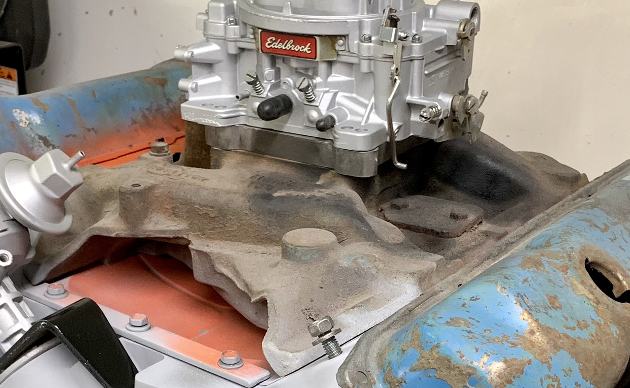

You got it - off a motor home - Notice no coil mounts? Got rid of the casting burs. Cleaned it up like my HEMI intake from Indy CH.  I wanted a WEIAND DP and Holly stopped making them. Loved those. I hate the looks of the Edelbrock DP. Because this is a show piece I modified it for looks over performance. Here is a before...

 No the intake is just a mockup for display. The intake was trashed on the inside I would never use it. The paint will take the heat - I've proven that with my HEMI that is painted the same.

clever stuff , no coil mounting bosses ,  confused me a bit  :ahum:   ,    like the blocking off the heat riser thing / manifold heat idea  :yesnod: :coolgleamA:
