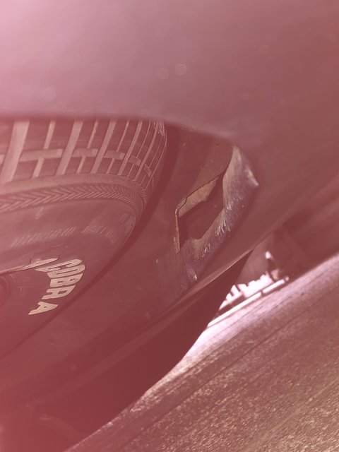

Just wondering what this brace type thing is under the front wheel arch of a 68 ?
Just for strengthening the front fender ?
It's just that my tire is slightly rubbing on it on the driver's side on right turns and bumps
I can go a smaller tire but just wondering if anyone has tried adjusting it for more clearance ?

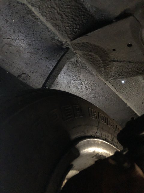

It's rubbing on the bit just on the wheel arch lip/outer edge of tire(2nd pic)
Thanks
Mike DC
It's just part of the OEM fender structure.  Of course it can be modified, but don't get rid of it entirely or the fender skin will flop around.
If you start modifying it, be careful that you don't move the whole main fender skin in the process.  '68 Charger fenders are a lot more valuable than tires.
 :Twocents:
If the tire rubs during normal driving then it's usually too big, period.  Normal driving is a poor test of clearance.

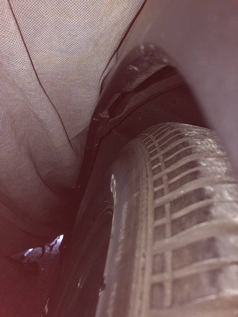

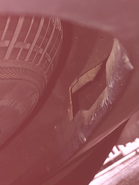

Below is some better pics
The first 2 pics is the drivers side which rubs on that brace
The 3rd pic is the passenger side that doesn't rub , looks like someone has already moved that part up in the past because there's much more clearance on that side , thanks
url=https://postimages.org/][/url]
70 sublime
Looking at your pictures it looks like the pass side brace looks normal and the driver side brace is bent down some or has a twist to it
Think I would bend the driver side up to look like pass side

What's the easiest way to bend it up ?
Just a bit worried damaging anything after what DC said above
70 sublime
If it was mine I would just get a piece of wood like a 2x4 and get it up in beside the rubber tire and pry the brace back up
Or get some vise grips on it and bend it back up
The driver side looks like the edge of the brace has got caught on the tire and really twisted it down some
