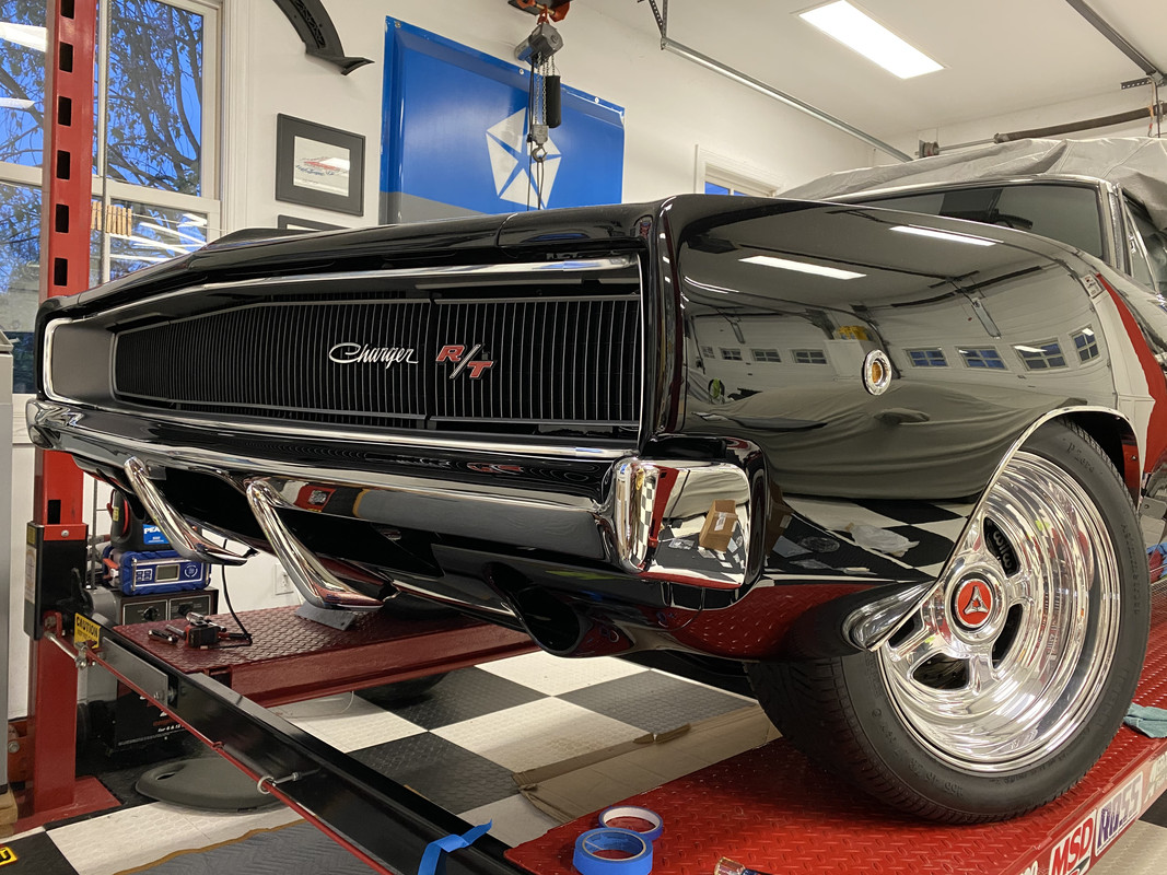

keepat
Finished the exhaust with the install of the S/S tips. Also installed the grill and finished the headlight wiring. Then the aluminum & carbon fiber bumper mounts, and valance. And started working on the front brake air intakes and mounted the horns under the headlights

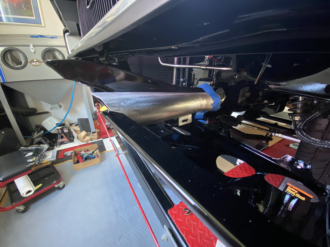

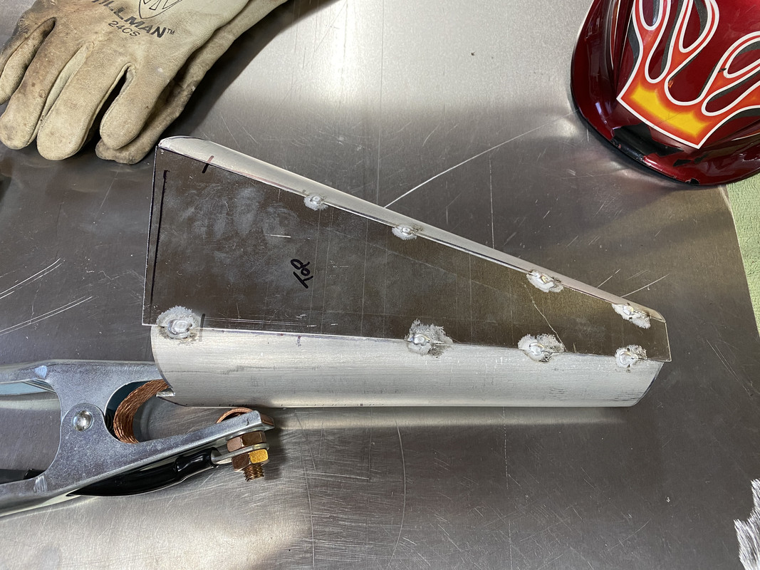

keepat

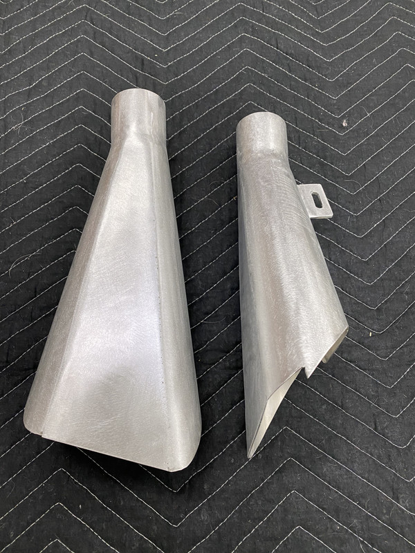

Front brake air intakes are ready for paint just need to install the bumper and do any final adjustments to them.
Thanks
Pat
INTMD8
Quote from: keepat on April 13, 2021, 03:33:48 PM
Quote from: INTMD8 on April 13, 2021, 02:43:39 PM
Like everything else with this build, the paint is amazing  :drool5:
I may have missed it, what was your process for cut and buff?
Page 52 post#1684
http://www.dodgecharger.com/forum/index.php/topic,110212.1275.html
Thank you! So if I'm understanding correctly you started with 1500 and nothing courser? I'm surprised it ended up that amazingly straight without starting with blocking with 800 or so.  Speaks to your ability to lay out material nicely. It's gorgeous!

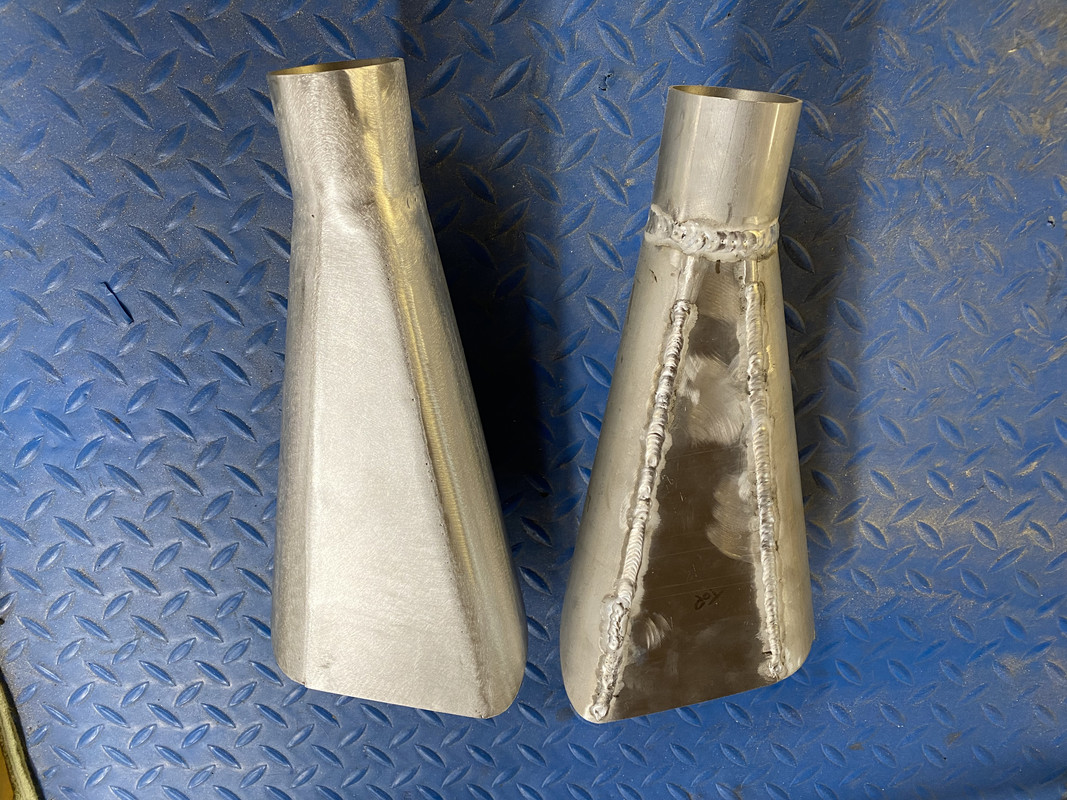

Your brake ducts turned out awesome as well. Just to throw in .02, even if perfectly wiped down clean, I've found it's a bit easier to weld aluminum like this if you first take a fine 3m roloc to all areas that will be welded.  (to remove invisible surface oxidation).
At that point, with how nice your fitment is you can start the weld with filler rod and finish the entire seam fusion with no filler.
Won't change the end result but saves time knocking down the weld bead.
If you ever sell this thing set reserve at a million.  :2thumbs:

Thanks for the aluminum welding tip! Maybe on the next car I'll have this tig welding figured out;-)
Pat

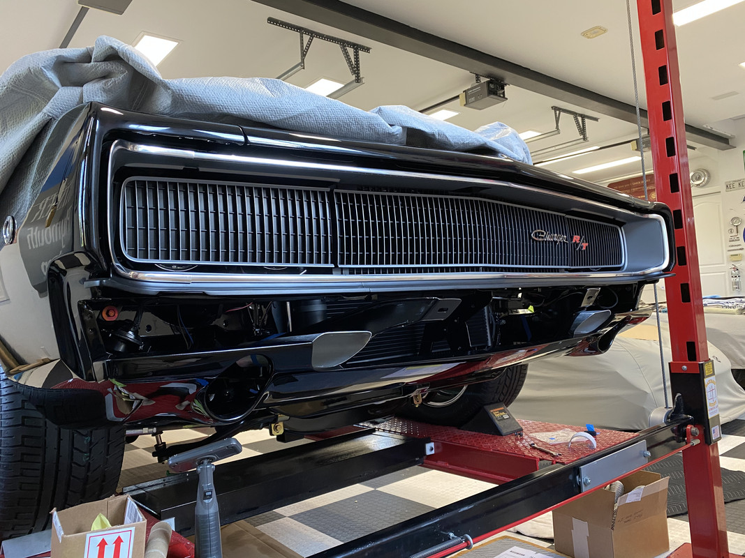

keepat

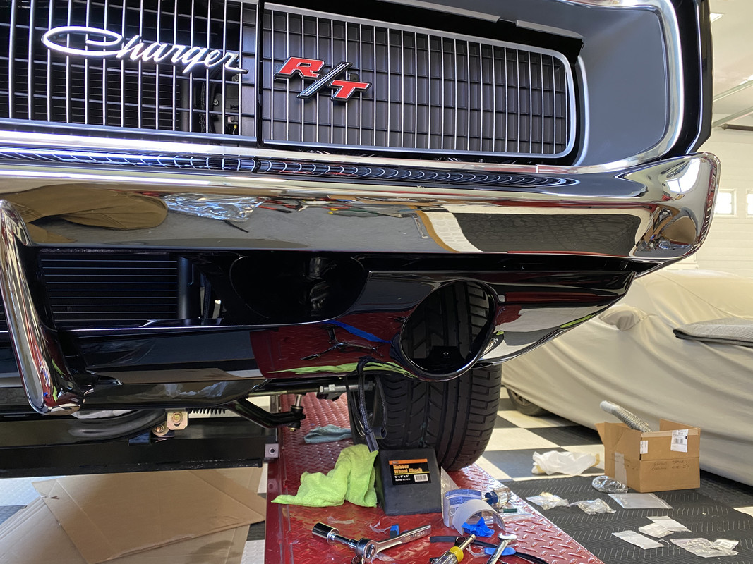

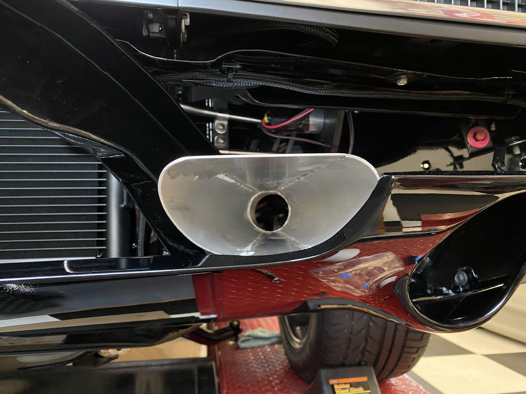

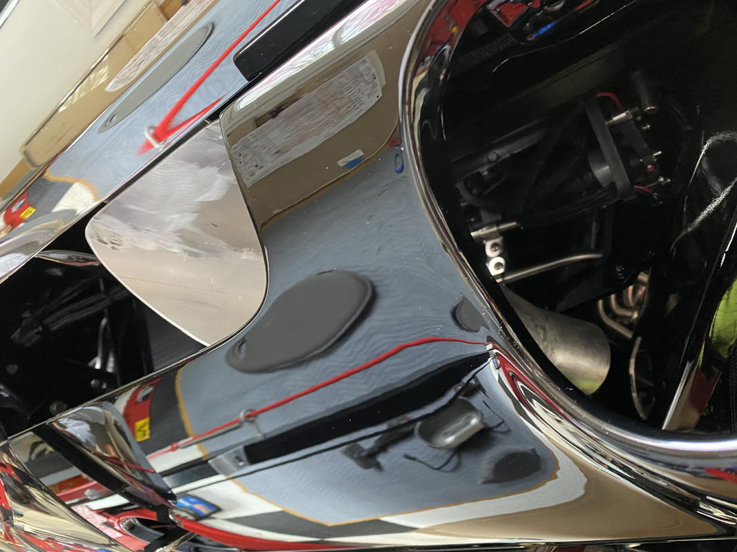

Mounted the front bumper, and painted & installed the front brake air ducts. The air ducts are inconspicuous painted black.
Thanks
Pat
