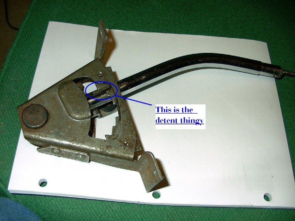

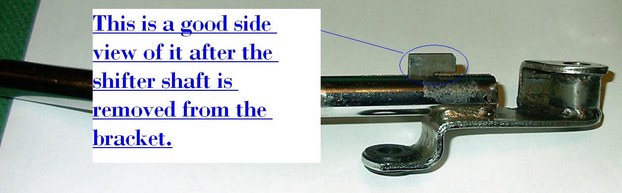

There's a detent mechanism at the bottom of the shifter. The goal is to get this piece removed from the cable in order to facilitate the removal of the shifter knob.
This gives you a better idea of what you're looking for.

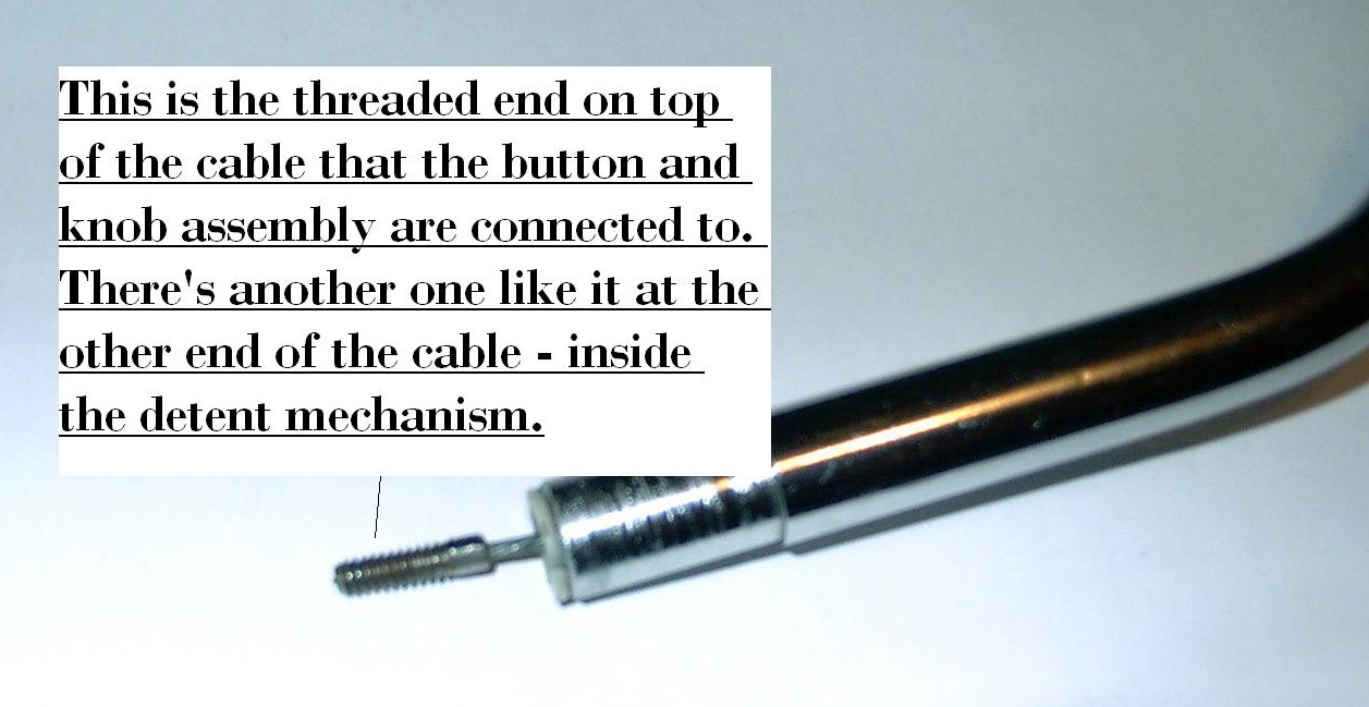

This is what the cable looks like - but this picture shows what it looks like at the top end. The bottom end is the same. This picture is just to give you an idea of what you're trying to do.

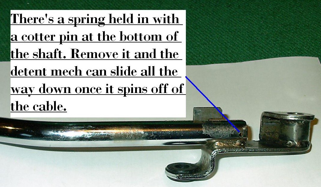

First thing to do is unscrew the cable from the detent mechanism by turning the shifter knob - the thing we're trying to avoid. Then, remove the spring at the bottom. This will let the detent mechanism slide down in the shaft.

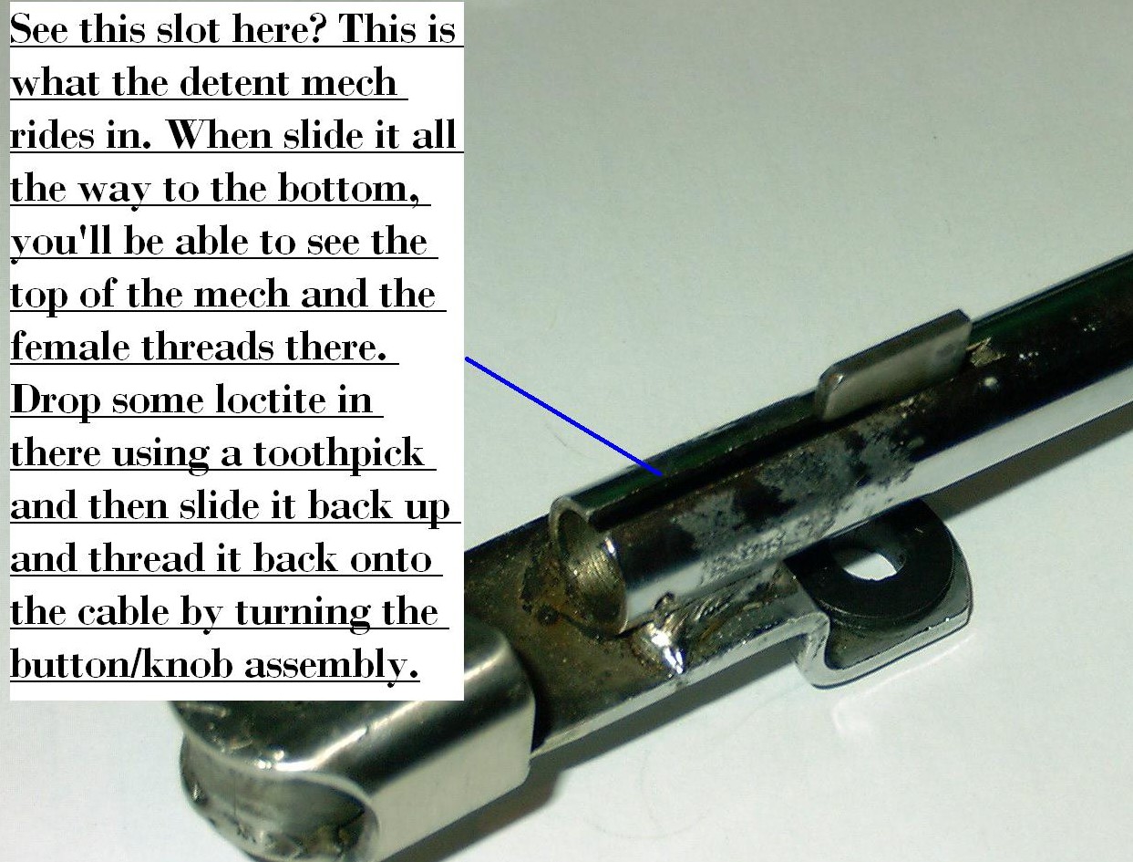

Now, we can see the threads inside the detent mechanism and the cable is still stuck to the shifter knob..
Drop some thread locker in there and screw the cable back in. This will hold the cable in the detent mechanism so that when you start to unscrew the shifter knob, it will unscrew from the top of the cable instead of unscrewing the cable from the detent mechanism.
