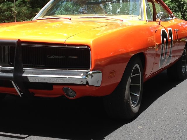

I used the tape method too. I blocked one side of the bodyline using masking tape (also use a guide coat on your filler to see what you are doing). After I was happy with how it looked/felt I sprayed on a thick layer of polyester filler and blocked some more.....then another coat of polyester, blocking.....then two coats of urethane primer....blocking both coats. Lines are sharp and arrow straight.
One tip, sort of a pet peeve of mine, alot of folks block the line in all the way to the front edge of the fender (like in pic of general lee), when in fact it should feather out about 6-7 inches from the front edge (bottom pic). But its what ever floats your boat, I guess. Alot of people frown on filling in rear valance seams, and I did on my because I prefer the smooth look.
