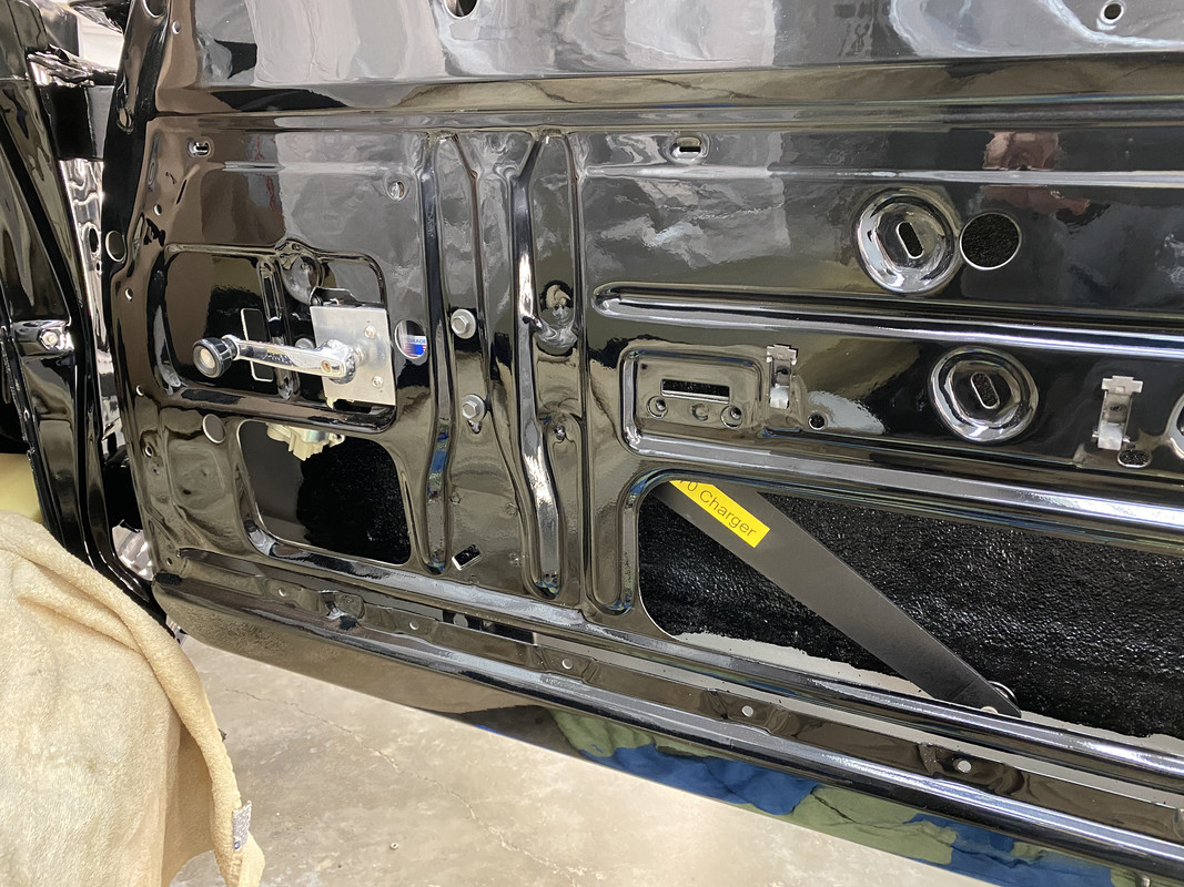

I hung the right side door over the weekend. Drilling all the hinges both in the door and on the car with an 1/8" drill bit, (when the car was in primer before disassembling) then used them as an alignment tool made the installation very easy. I also used an 8 pound weight wrapped in a towel inside the door to simulate the weight of the glass and vent.

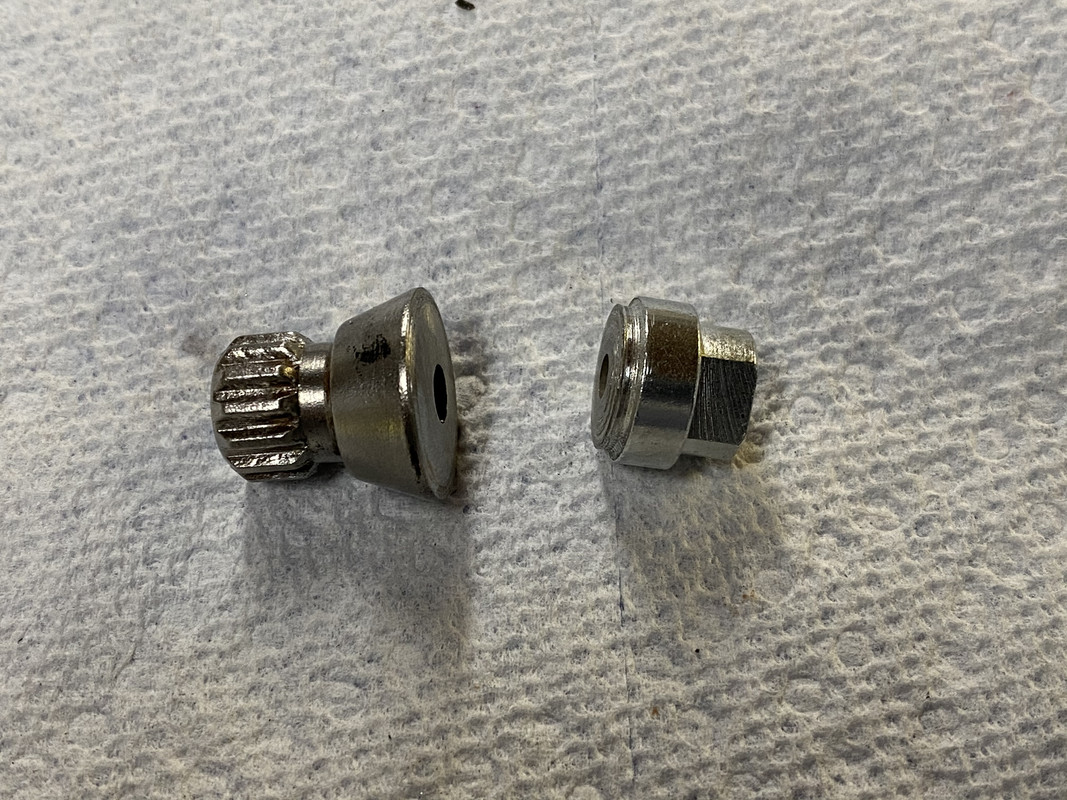

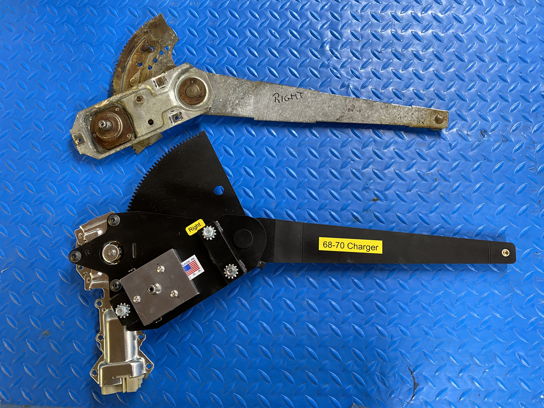

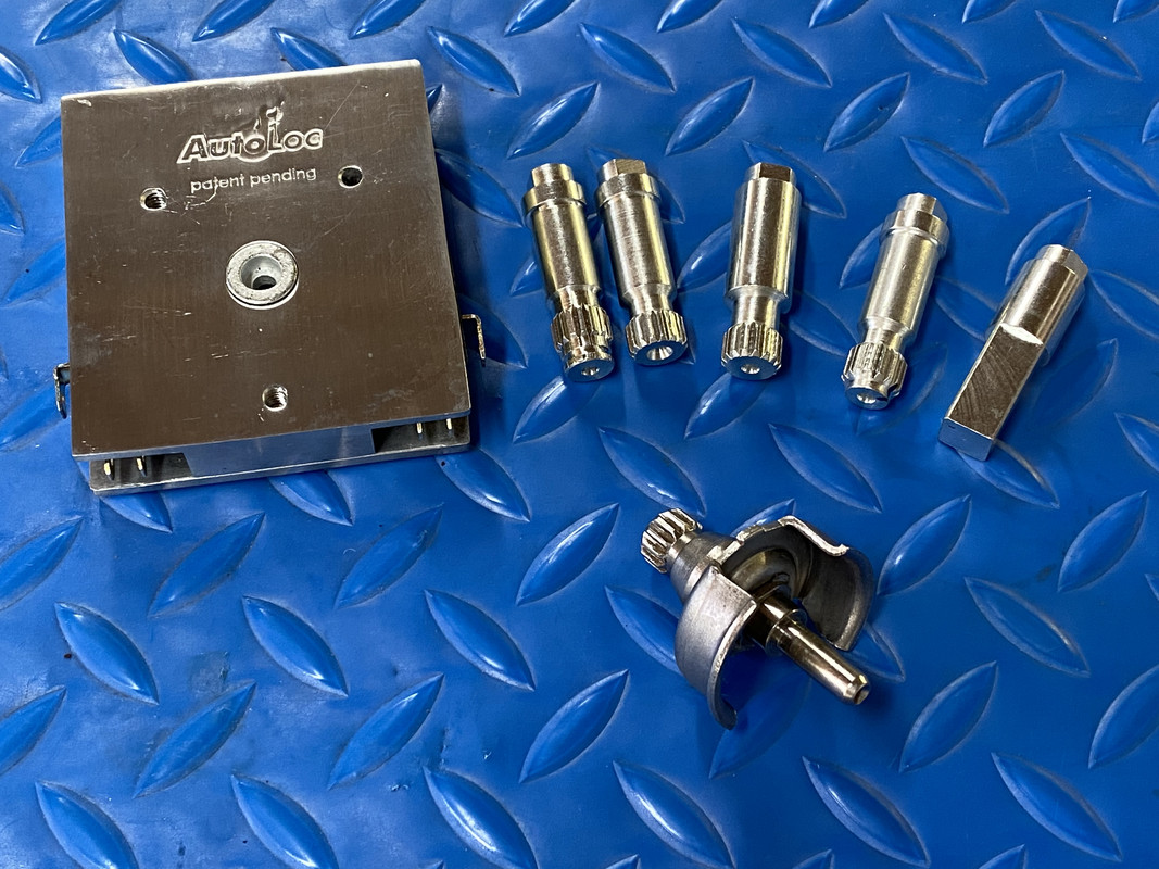

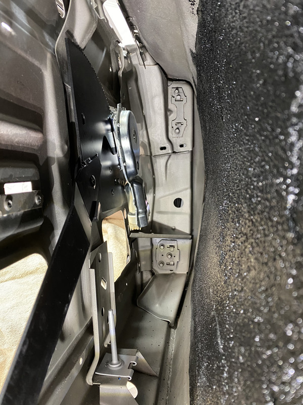

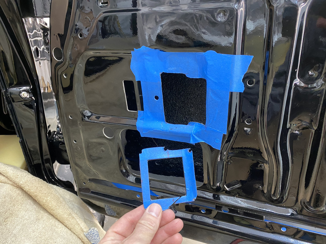

Installing some of the door hardware is a tedious process with new paint, but so far is going well! The new power window regulators are nice but I spend a lot of time laying out the electric crank switches. The power crank switches do not come with a Mopar adapter so I needed to cannibalize a crank handle shaft from an old rusted regulator and welded it to part of the new crank shaft. The crank switches work the power windows by moving the handle up or down about 15° to contact microswitches. A cool set up if you want power windows but the look of manual window cranks. All of my original window regulators are in excellent condition so I'll need to find some rusted regulators to salvage the small crankshaft for the other three windows. PM me if you have some broken, rusted or bad window regulator's
Thanks
Pat

Quote from: keepat on March 25, 2020, 09:39:08 AM.....The power crank switches do not come with a Mopar adapter so I needed to cannibalize a crank handle shaft from an old rusted regulator and welded it to part of the new crank shaft.....All of my original window regulators are in excellent condition so I'll need to find some rusted regulators to salvage the small crankshaft for the other three windows. PM me if you have some broken, rusted or bad window regulator's
Nice work Pat.  :2thumbs:
So you're saying that you need 3 more window crank shafts to attach or replace these shafts from your pic? (attached below). I'm pretty positive that I have some beater 1973 B Body regs laying around. I would be more than gladly to get these to you as these regs are sitting around doing nothing. At my swap shows they hardly even get looked at. I know that 1966-74 Mopar has the same shafts.
But I can't get to them for at least the next 2 days and I'm not sure if I have 3 of them.
