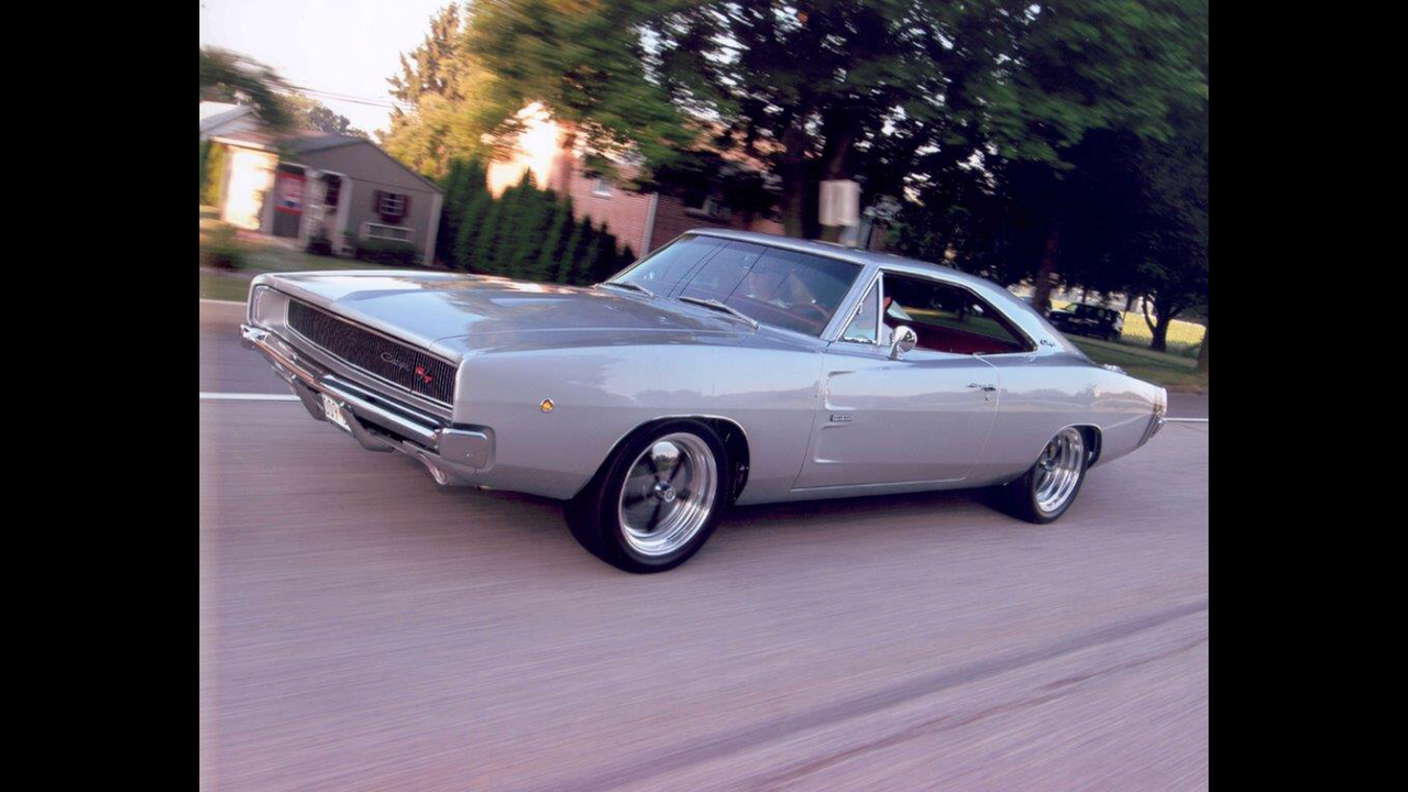

The car has been sold a few times since I built it in 2006. It is now in central PA. Here is a link to an article written about the car in 2012.
Thanks
Pat

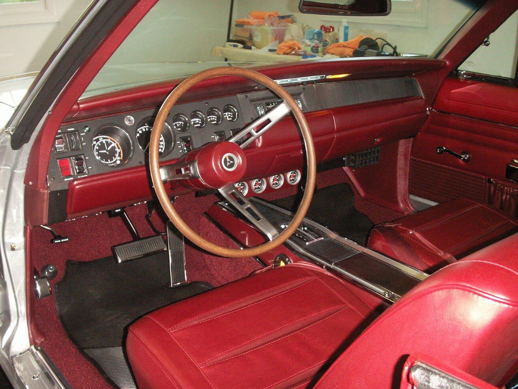

Mike, Funny thing is, if I had kept the silver charger I would've never taken on another charger project. My plan was to build a 66 GTO similar to the way I built the Black Charger. But when my younger son said he wanted to build a Bullitt mustang I figured I might as will build a Bullitt charger to go along with it;-)
That's said, I have no plans to sell the black charger! One day I'll get to that 66 GTO and relive my high school car;-)
Thank you!
Pat
PS. don't kill me for posting my high school car picture;-)

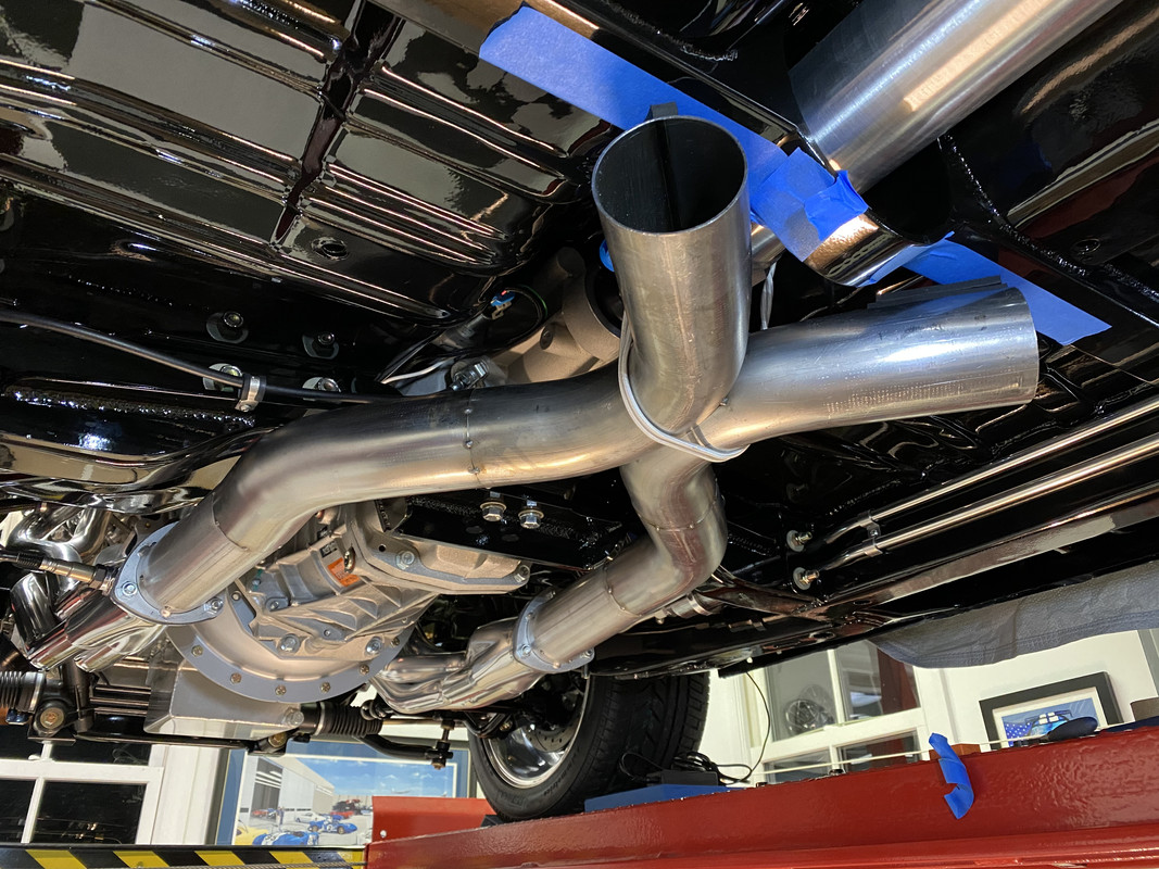

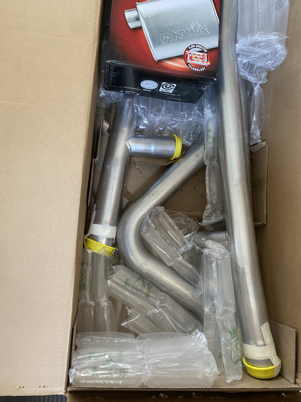

Received a set of 3" TTI exhaust this week. Looking forward to installing the system and adding electric cut outs. After it is modified to fit I will send it out to be ceramic coated to match the headers.
Thanks
Pat

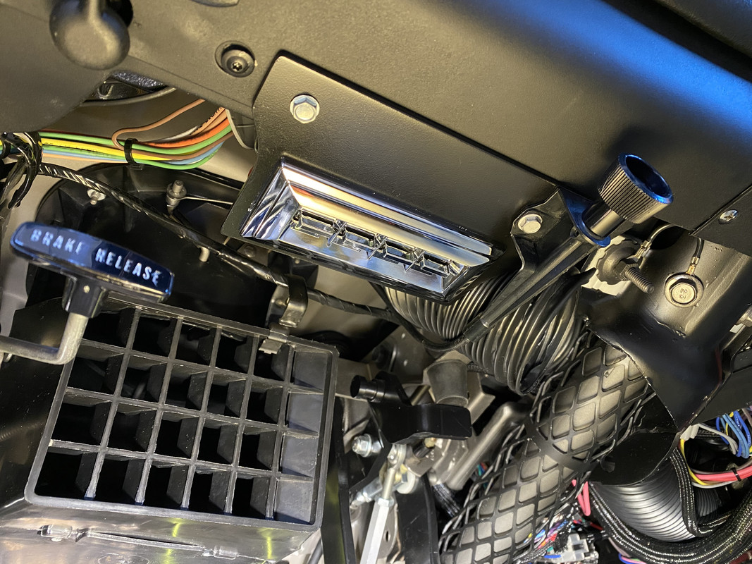

I install the power window switches under the dash and as I have crank window switches installed I don't need the driver side switch so I plan on using that for the exhaust cut outs.

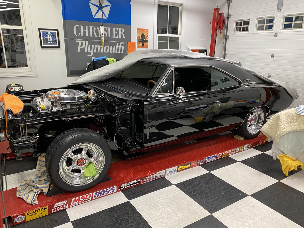

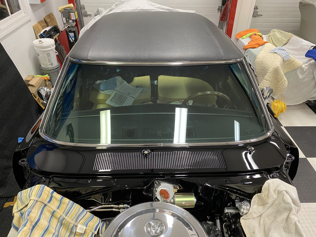

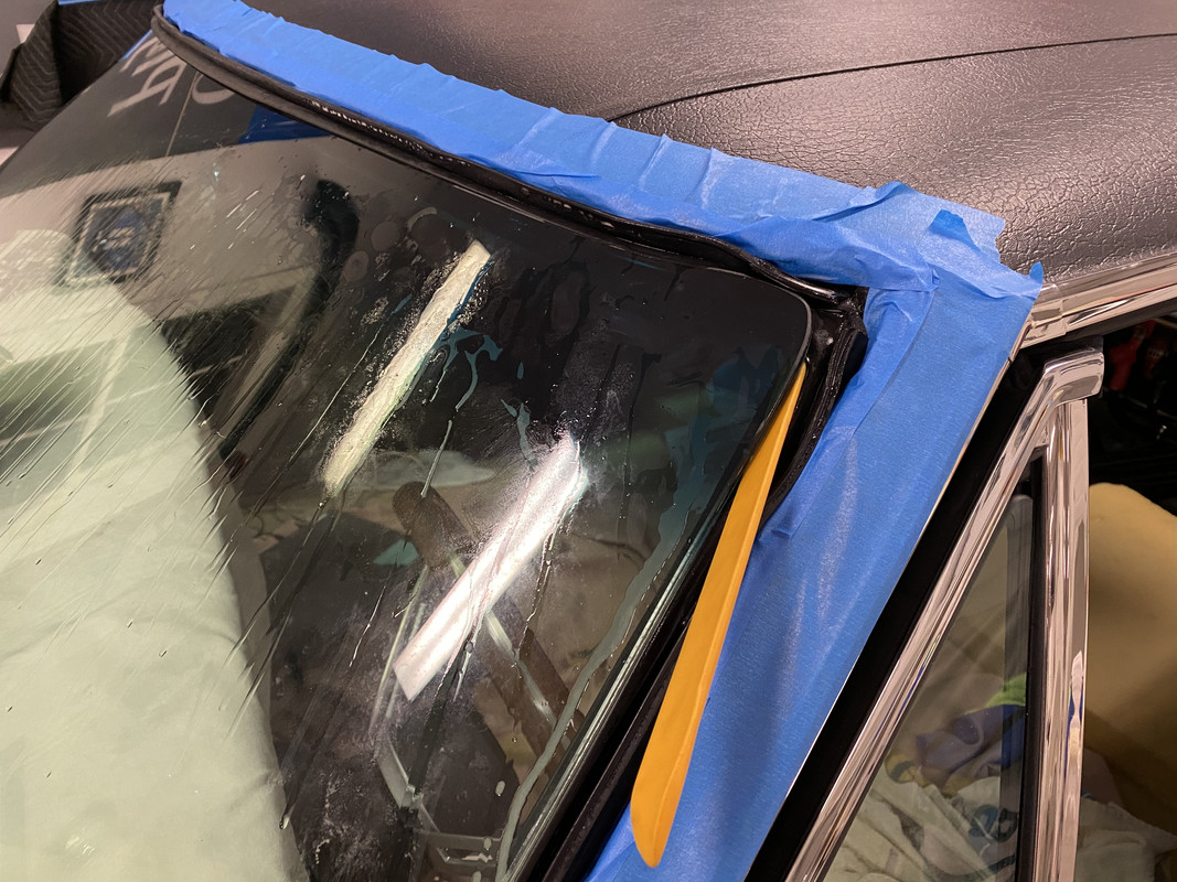

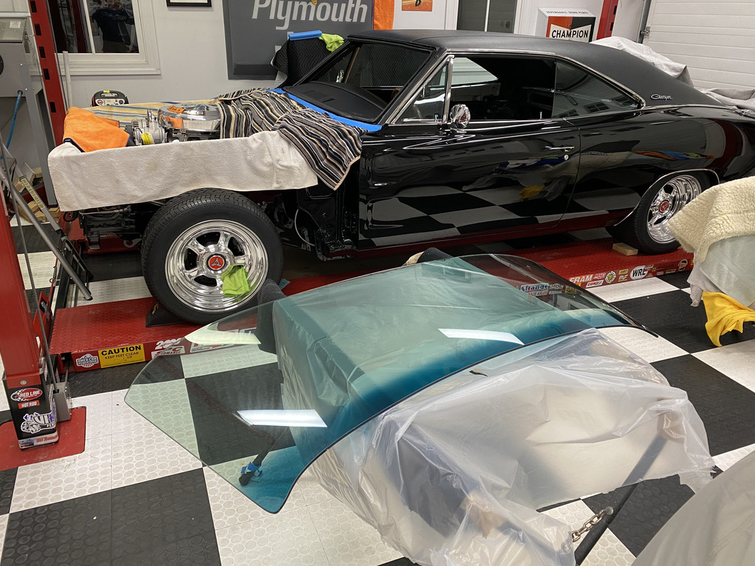

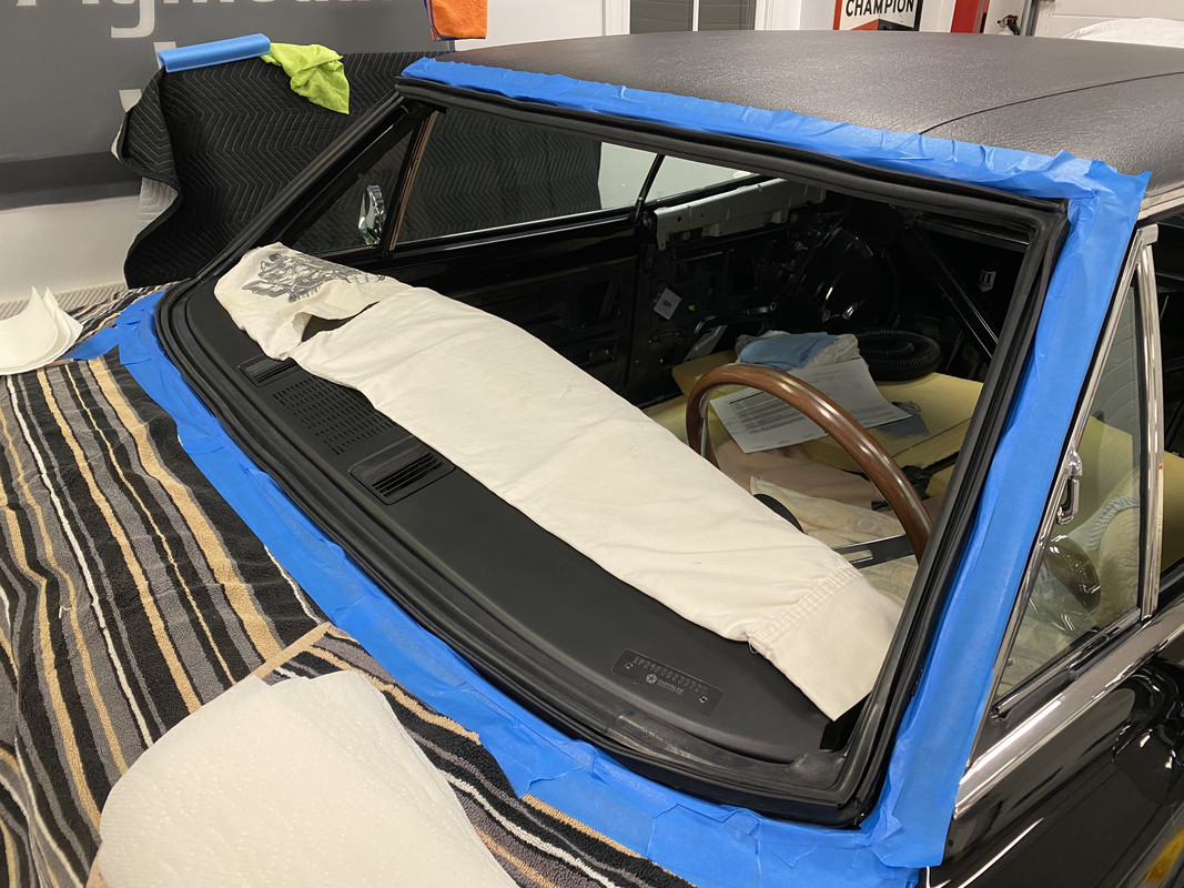

Install the windshield last night. The AMD glass fit great along with the year one gasket. Caulked the metal and glass track with Butyl rubber sealant. Will do an ultra sonic sound leak test before installing the stainless trim.
Thanks
Pat

keepat
Quote from: Ryan on January 30, 2021, 09:14:48 PM
when are you putting the front clip on ?
are you doing hemi door badges ?
I was holding off on the front clip until the windshield was installed so you should see the fenders go on in the next few weeks. And there will be no hemi badge as the bullitt charger did not have one.

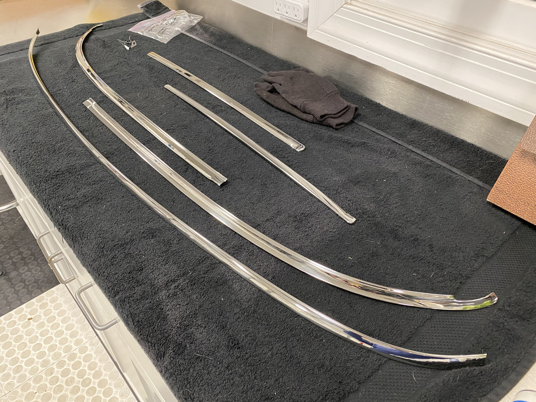

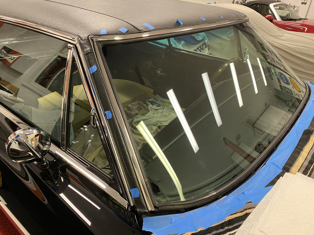

keepat

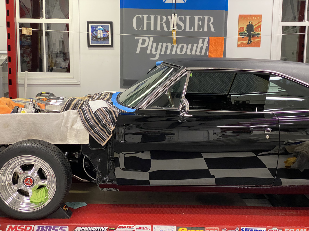

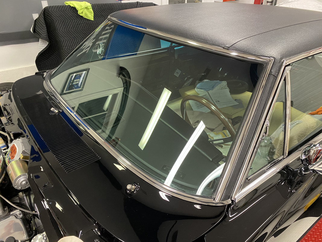

Windshield trim install with no problems other than sore palms;-)
Pat

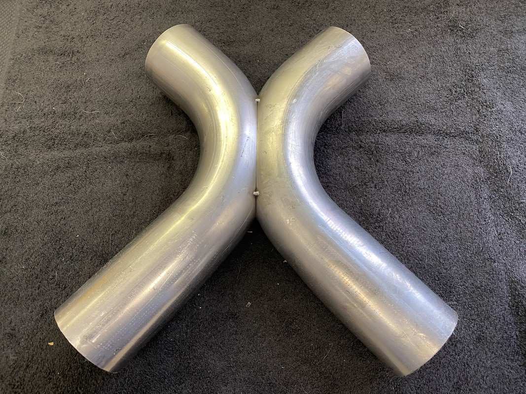

keepat

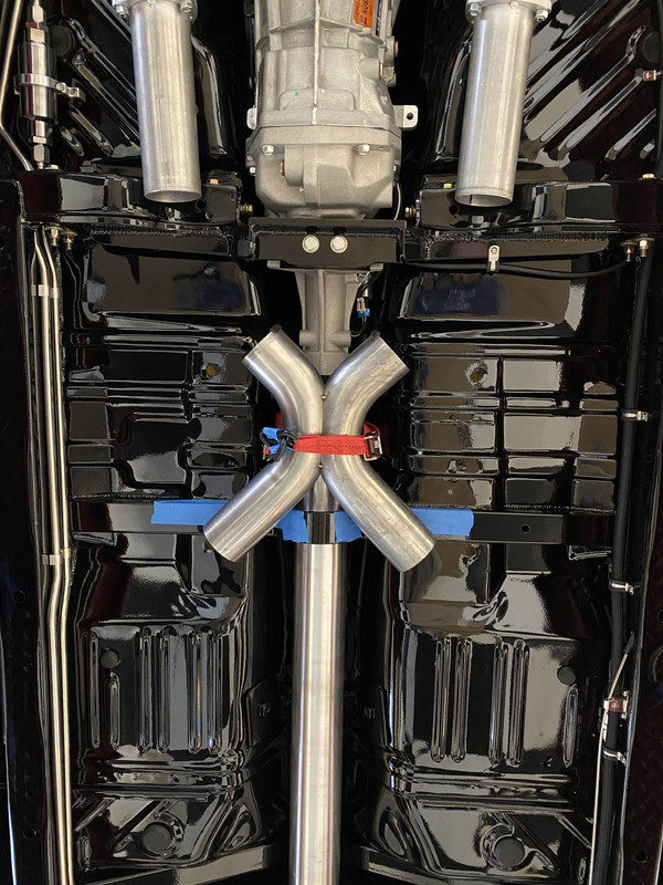

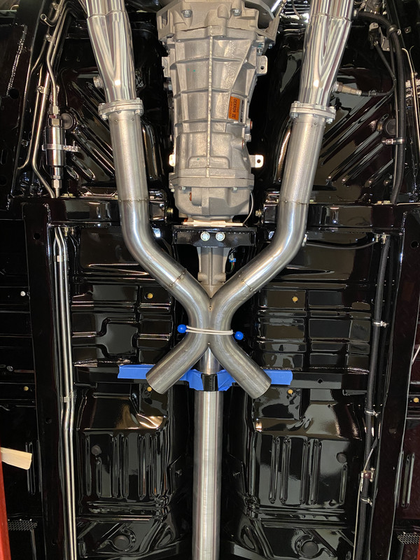

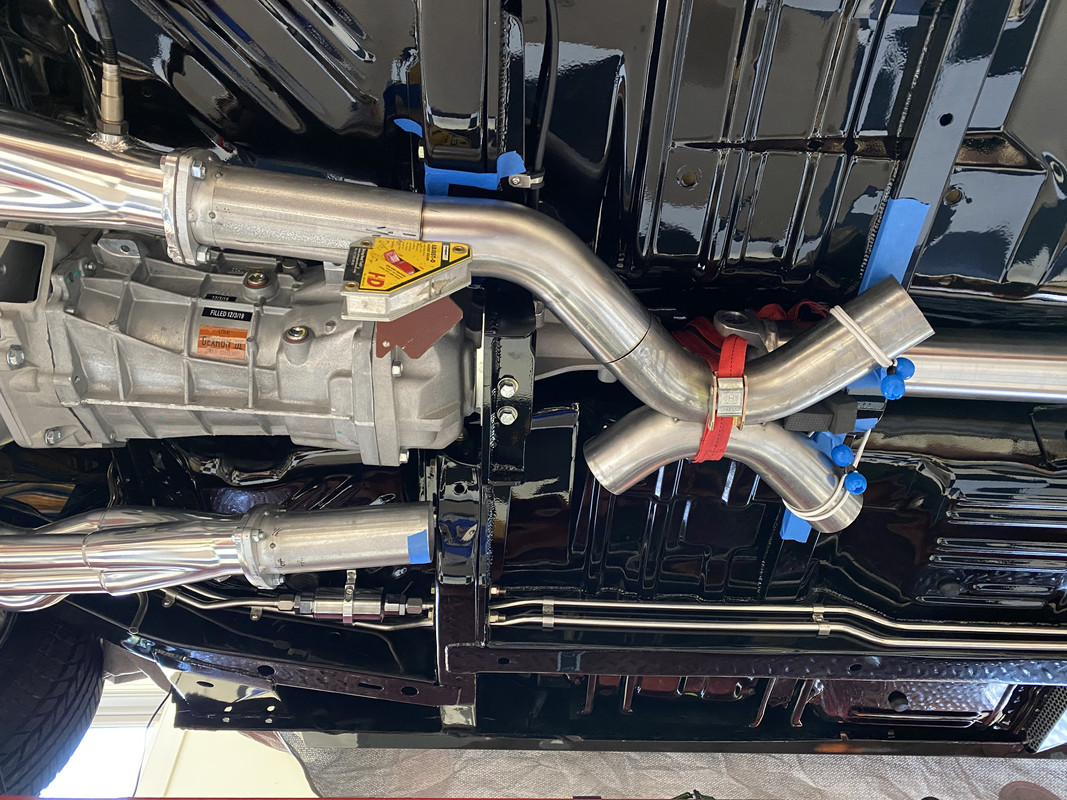

Good day to be stuck in the shop with a snow storm. Started to make the custom X pipe to fit between the trans crossmember and driveshaft loop.
Pat

I was wondering, what are the benefits of the X-pipe over a separate pipe running down either side?
Cheers,
Matt.
keepat
Quote from: orange383 on February 01, 2021, 08:22:14 AM
Good job on the windshield and trim Pat.
On my first Charger I fitted the screen and trim after a repaint and the trim didn't fit very well.
Cheers,
Matt.
Matt, Sharing the exhaust with the X pipe = better flow, Better flow = more HP;-)
Thanks
Pat

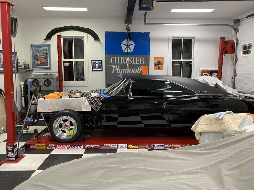

TexasStroker

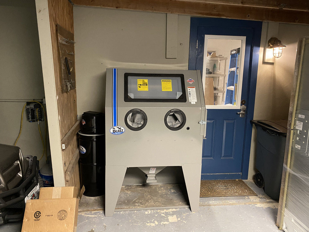

Just noticed the blast cabinet over in the corner...how do you like the Skat Blast?  I'm toying around with getting one at the house.

Cheers,
Matt.
Thanks
Pat
Thanks Pat. I never realised that!
keepat
Quote from: TexasStroker on February 02, 2021, 01:15:04 AM
Love it! Be sure to get their vacuum system!
Thanks
Pat

Glad to hear and will do!  I always like having first hand feedback when possible  :2thumbs:
Believe it or not l just received another Skat Blast cabinet. I set it up today at our Florida marina.
Very nice USA made cabinet!!

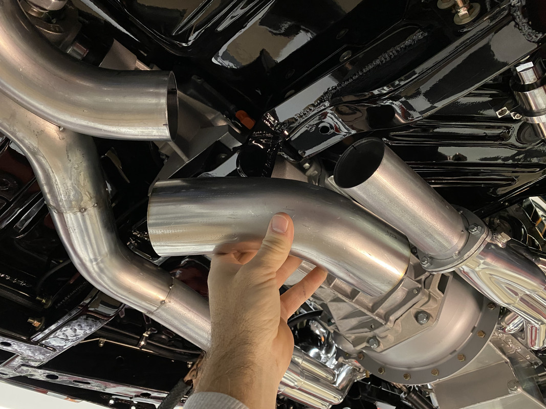

Slowly cutting, sanding and fitting the exhaust puzzle piece by piece;-)
Pat
