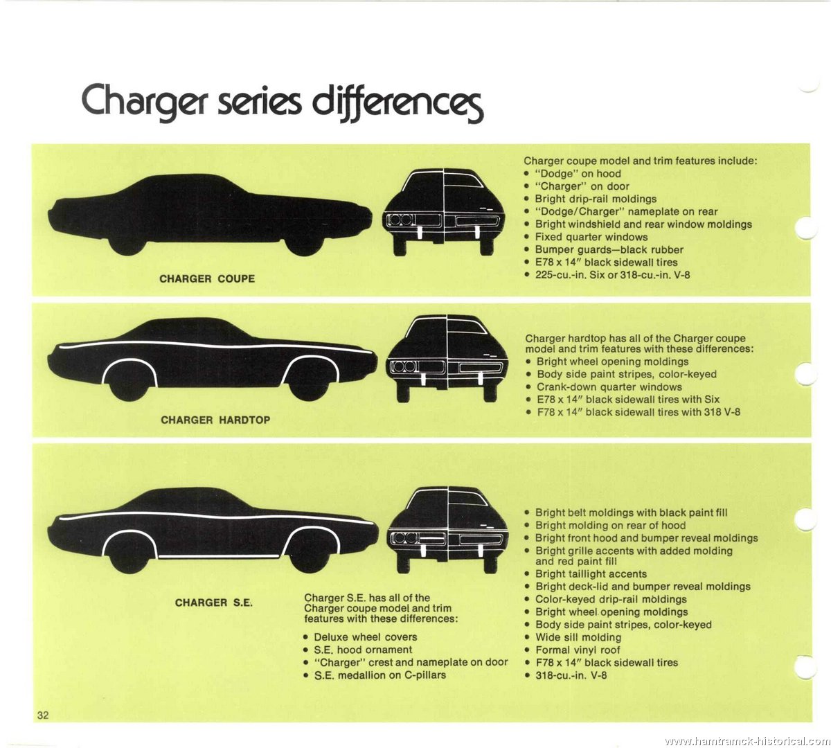

Quote from: Moparbob on February 03, 2008, 03:50:43 PM
Hey,
Whats the trim called around the rear bumper (Where the rubber was) and is there trim on the front too?
that trim does not take place of the rubber filler and in fact they lived together on SEs. Is attached to body instead the bumper like the fillers. Was available on all years the same, including 71/72s where fillers didn't exist
I can't recall how is named. Mostly sure 69CoronetRT will float someday with that LOL
we talked about that here:
http://www.dodgecharger.com/forum/index.php/topic,38510.0.html
judging by what Tufcat replied:
My 1972 Charger Rallye had it..... It also had the optional (M28) - front bumper reveal moldings, and (M36) rear bumper reveal moldings.
that's the name...  bumpers reveal moldings ( M38 and M36 on tag )
