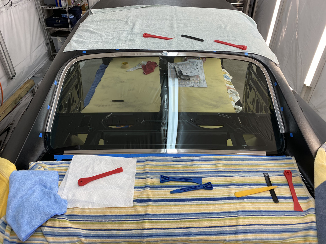

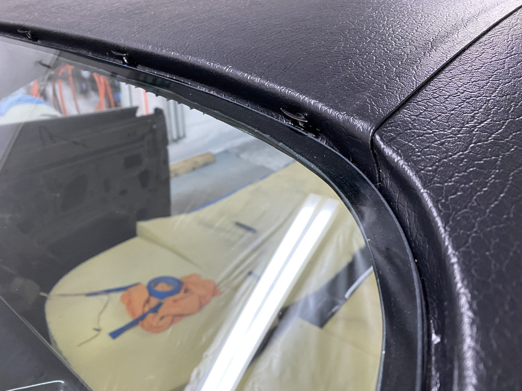

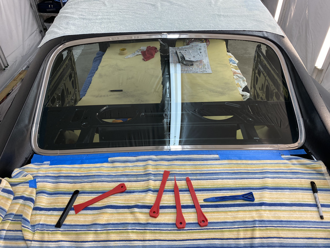

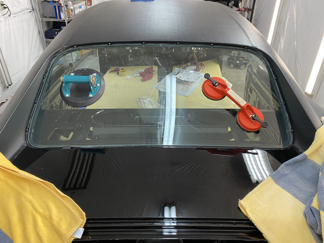

Not a fun weekend installing the rear glass and trim. AMD glass was not a problem but fitting the trim took two or three times to get everything just right. Fortunately no chips or scratches just a lot less hair on my head ;-)

Looks great! Always a sigh of releif when the rear window trim is done....

Quote from: Charger-Bodie on December 30, 2019, 05:14:10 PM
Yes! The other fun job is the rear side window regulators. Always good for colorful language ;-)

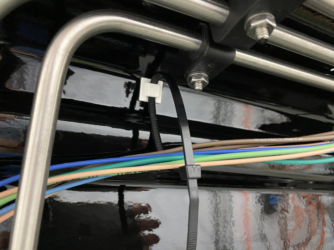

keepat
Weld Mount is in acrylic adhesive mounting system with a wide variety of very cool fasteners. We use it on the boats when we cannot drill into a bulkhead, fuel tank, or hull sides to mount or fasten equipment and wires. I used it to mount a few fan relays and headlight door operator To keep the engine bay clean of fasteners. Very cool stuff, easy to use an extremely strong!

 :o  Wow! looking fantastic Pat, that Weld Mount system is a thing of beauty, I can see so many uses for that.  :drool5:

Quote from: timmycharger on January 06, 2020, 07:19:22 PM
We have used it for years on smaller boats where the console is thin fiberglass and you can't put a screw in it. Works great for hanging electronics components on thin fiberglass or aluminum fuel tanks. I have yet to see any of them fall off with many years of pounding seas.
